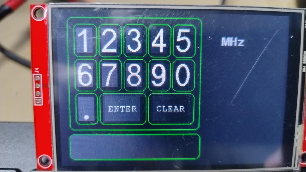

58kk90
Joined: 14/06/2023
Posts: 82
Posted: 06:32am 30 Sep 2025
Thats what I have started to do, use separate gui buttons' for each digit, surrounded by a frame.
Looks like this so far
Still a bit to do to tweak it to look nice, but I can enter a frequency and it is displayed in the box below the keyboard as each digit gets entered.
Sorry for the hair stuck to the plastic film on the front of the LCD, I should have peeled the film off before taking the picture!
