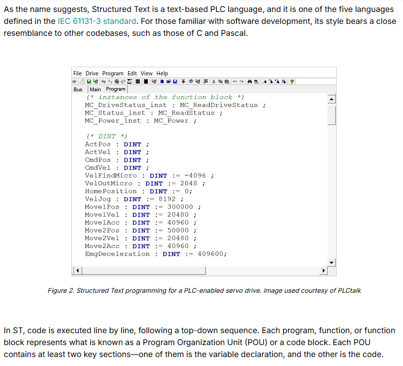

Posted: 02:44pm 23 Sep 2025
"Let's use := instead of = and a semicolon to terminate each line so that we don't have to admit that it's BASIC"
Posts: 12176
Posted: 04:38pm 23 Sep 2025
Having a line termination character like ; allows a statement to be split across multiple lines
Basic = confuses assignment and equivalence. If you read := as "becomes equal to" then = is just the equivalence logical operator.
Personally, I like both but then my first language was Pascal

Exactly, all you doing is the work that the compiler writer should have done.
everyone knows when you have a comparison or assignment.
In all the years that I have been programming (mainly old assembler stuff) there was never any issue between the two in whatever language was used. It was defined by the operation.
Also
Move1Pos : DINT 3000000 ;
Type of syntax seems very clumsy. There is no need for the : between the variable name and the type, the space delimits the two, I don't know anything about this language but I'm a bit suspicious of the : (maybe the ; as well) It looks as if it is looking for {space}:{space} or {space};
i.e.
would this confuse it?
foobar   : DINT 3000000 ;
boojum : DINT 3000000   ;
If so it's just as bad as the Python indent madness and the programmer is being made to do the work that the compiler writer should have done.

Posted: 08:10pm 23 Sep 2025
In such as
Move1Pos : DINT := 3000000 ;
it looks like the spaces are optional and put in by a human who preferred them.
I can't see anything wrong or odd about that.

Posted: 08:20pm 23 Sep 2025
  JohnS said  In such as
Move1Pos = 3000000
Job done. Why the BS?

Move1Pos = 3000000
I expect they want to define its type so it can be checked and/or more efficient code generated.  Neither of those is BS.
Defining type helps avoid programming bugs
MMBasic with OPTION EXPLICIT does that, too, or are you saying that's BS?
Edited 2025-09-24 06:55 by JohnS
PhenixRising
Joined: 07/11/2023
Posts: 2149
Posted: 10:42am 24 Sep 2025
No I like OPTION EXPLICIT due to my lousy typing
But this is cleaner/more refined:
dim float strt,fini,mcmd,i,a,b,c
