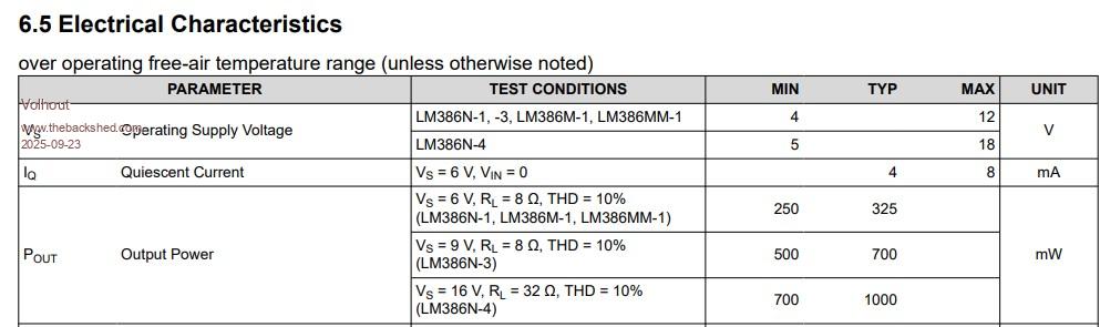

Hi,
LM386 cannot provide a lot of power when powered from 3V (3V3), this advertisement is a big lie.
- use 5V minimum
- 12 watt... NEVER, 1 watt is more likely.

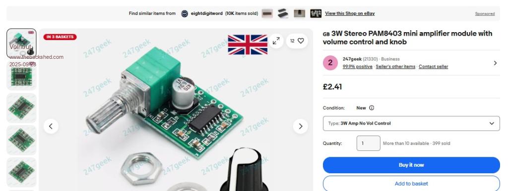

Posts: 6253
Posted: 09:49am 23 Sep 2025
I use this in combination with picomite. Powered from Vsys (4.5V) but it runs from 3.3V as well.

  Volhout said  Hi,
Who said I was powering mine from 3v3?
I'm using 12v for the amp module, rendering around 500mW or so of output with relatively low distortion.  I tend to ignore any of those output power figures, when they state a distortion of 10%, cos that's a hellishly high distortion figure!
As per the claims in the listing - yeah, they often lie, but I am trained to ignore anything they say in the tech specs side of most of those listings now.  Locate the main device - LM386 in this case - then use the authentic device datasheet, so as you say around 1W maximum at about 16v with 10% THD, so certainly not Hi-Fi as I mentioned, but perfect for sound effects etc.
But using 12v for power.

Ah, the "for your MMBasic requirements" led me(and, I assume, Volhout) to assume a 3V3 or 5V supply. :) Certainly, when you can get 9V or more there is a much bigger range of chips.The LM386 has been around for about 30 years now, from a time when it was rare to go below 6V for anything audio-related. Still a nice chip if you don't push it too hard.
