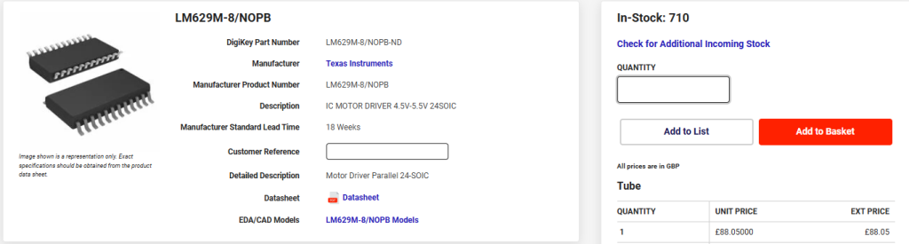

I totally ignore conventional "wisdom" when I see potential. I have been looking at these ESCs with a view to closing the loop on a brushless motor. The PicoMite has PID and we are able to read encoders at high speed via PIO.
There is a motion controller IC LM629, that is widely used in industrial controls but it only has 8-bit motor command (+/- 127) and is limited to 1M quadrature counts/sec.
The PicoMite not only out-performs it but it has time to spare to run sequence code and of course lots of I/O.
The LM629 can only generate a trapezoidal velocity profile whereas I also have s-curve (much smoother).
Slight difference in price, also
At the moment, I drive brush-type motors but I think I'll grab one of those ESCs and a BLM to see what I can do.
Please keep us updated
