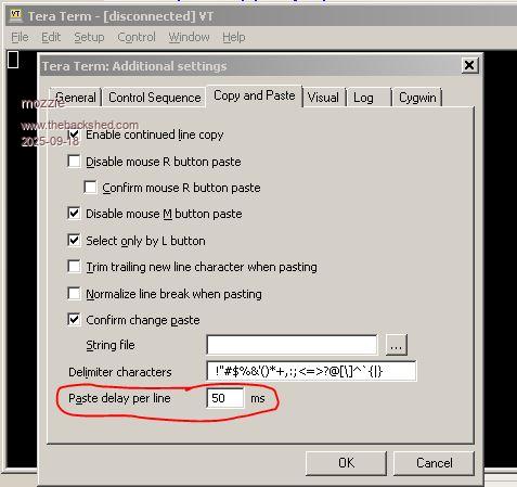

G'day Grogster,
If you go to:
Setup / Additional Settings / Copy and Paste
In TeraTerm there is a "Paste delay per line" at the bottom that may solve the problem.
Good luck.

Posted: 12:54pm 18 Sep 2025
G'day Grogster,
Did you try this?
If its set to 1000ms you can read the text line by line as it is sent.
This is TT4.100, hopefully exists in later versions.
Lyle.
