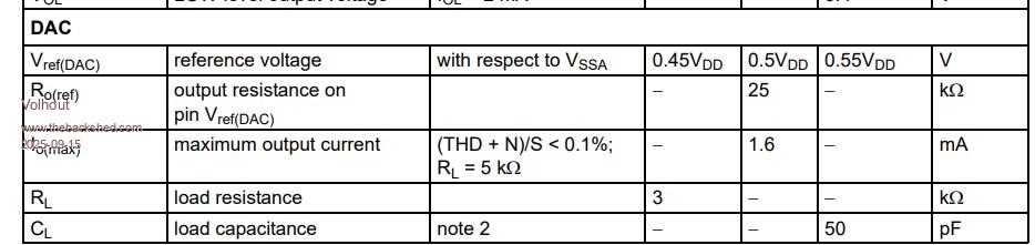

DC drift is not always specifically specified, but look at below datasheet.
Typical 16 bit I2S DAC UDA1334
DC accuracy is +/-10% (0.5V+/-50mV), relates to 3.5bits DC DAC. If that is sufficient, then you can use it as a DAC in your loop.
That is why it is normal to AC-couple AUDIO DAC outputs. DC drifts all over the place.
