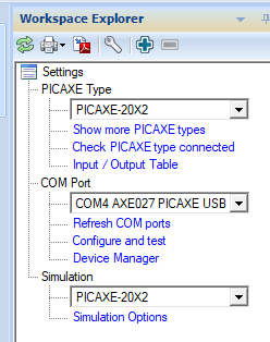

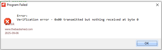

I have a temporary setup to load the program but I am receiving this error.
I am using  Picaxe Editor 6 to program the Picaxe.
The program has no problem when I use the simulator but upon loading I get this error.
I don't know if it is the cable or the driver.
I have attempted to load a couple of drivers but Windows always seems to say this is the correct driver.
Any ideas?

Stab in the dark.
Is COM3 correct?
Not at my PC to refresh my memory but I always have COM3 but it‘s (apparently) reserved for something.
Solar Mike
Joined: 08/02/2015
Posts: 1255
Posted: 11:22am 06 Sep 2025
Refresh the com ports, and select from the pick list, the port with AXE027 USB Driver.
Mike

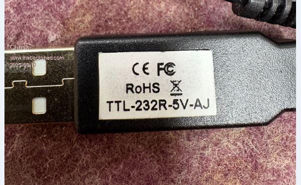

Here is the USB end of the AXE027 Chinese cable the other end is the standard 3.5mm audio connector.
The label does state 5V TTL.
Chrisk

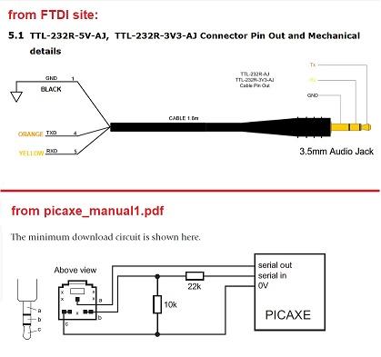

Posted: 12:12am 10 Sep 2025
I checked the code TTL-232R-5V-AJ and it's a standard FTDI usb to TTL cable sold by a lot of companies. The FTDI datasheet shows the 3.5mm plug as
tip is Tx
ring is Rx and
sleeve is GND (0v)
But the AXE027 is wired differently:
tip is 0V
ring is Tx
sleeve is Rx
Maybe that's the issue.
regards
Peter

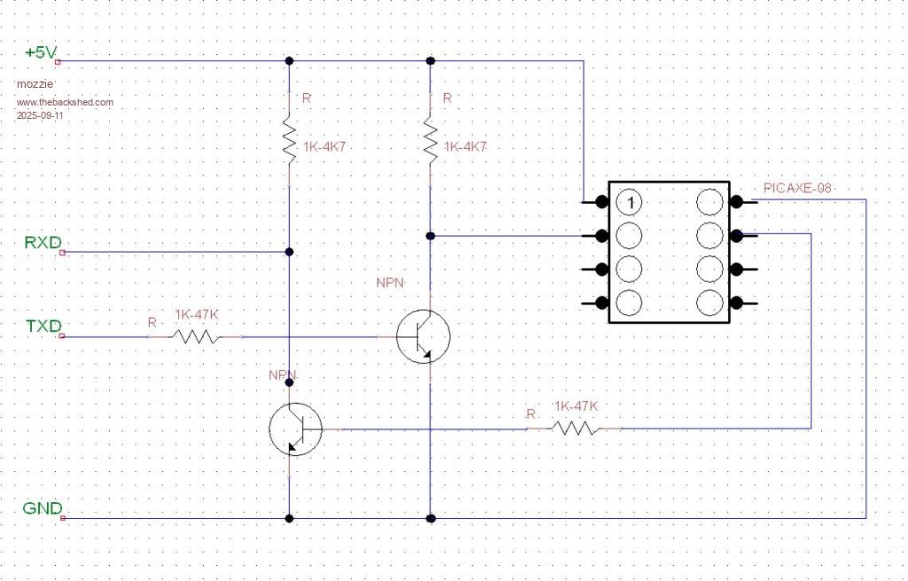

The FTDI wiring is standard. PICAXE have used nonstandard wiring so you need to buy their overpriced unit.
If the signal is standard TTL serial the polarity of the data needs to be inverted, as mentioned by Volhout.
TTL serial is idle high, data low but the PICAXE requires idle low, data high.
To check this plug it into a USB port and measure between sleeve (0V in FTDI diagram) and the tip (Tx in FTDI diagram). If you get near 0V you just need to rewire the plug by chopping the lead and reconnecting the wires.
If you get 5V you will also need a pair of logic inverters.
NAND or NOR gates will also work if the inputs are connected together.
A pair of transistors will also do the job.

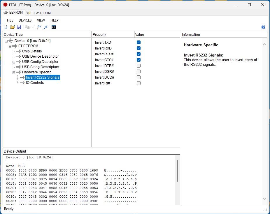

If it's using a proper FT232R IC inside the USB plug then there is a way to invert the Tx,Rx logic.
FTDI have a utility called FT_PROG which allows anyone to reprogram the IC's internal EEPROM. One of the parameters sets the logic of the signals. I've used the FT232R a lot but the only time I needed to invert the signal logic is when using it with a PICAXE. I haven't looked deeply into it but I don't think the CP21xx or Prolific USB-to-TTL ICs have this option. This is why Revolution Education use the FTDI IC.
Here's a screenshot of the setting using a genuine AXE027 & FT_PROG
Forgot to mention, if you do change any settings in the FT232R make sure you unplug and then plug the USB cable back in so it loads the new settings.
Edited 2025-09-10 11:46 by ElectroPI

If that doesn't work I have just tested a pair of transistors as inverters on a PIC32MX170 set to use inverted serial logic and it works fine at 115200 baud.
  Quote  OPTION CONSOLE INVERT
INVERT will invert the data polarity on both the console transmit and receive lines.
This allows the console to be used with RS232 signals without a converter (see the chapter "Low Cost RS-232 Interface" in Appendix A).
It also allows the use of a PICAXE style programming cable.

BC548 transistors, emitters to ⏚ (any general purpose NPN will do)
FTDI Tx -> 10k -> Q1 base. Q1 collector -> MX170 Rx and 1KΩ to Vcc
MX170 Tx -> 10k -> Q2 base. Q2 collector -> FTDI Rx and 1KΩ to Vcc
The base resistors can be up to 100kΩ and the collector resistors up to 4.7kΩ.
If you use MOSFETs (eg 2N7000) you won't need the base resistors.
To check if the tip or sleeve is ground clip a meter probe to the sleeve then probe the outer contacts of the USB plug. one of them is ground. If there is no continuity clip onto the tip and repeat.
