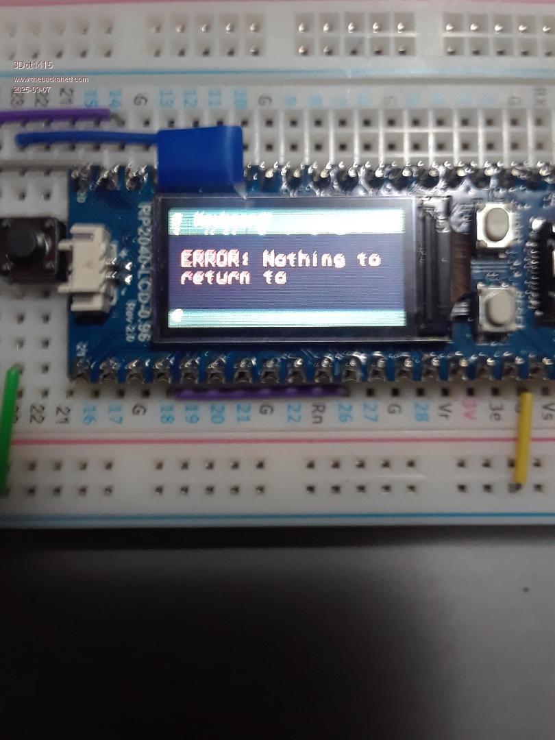

It took the simple uf2.
But then I had to stumble and poke around in TeraTerm to get OPTION LIST set
per Steve Johnson project, verbatim.
Then I transferred Picoscope.bas. Screenful of errors, but the last two lines went to LCD so it works.
Error : Frame buffer not created
>   FRAMEBUFFER COPY F,N
> End Sub
Error : Nothing to return to
> clearTerminal done
Need more Help please.

I think it's a file transfer issue.
XMODEM freezes
If I use send file instead, with 300ms per line delay I can see the program scroll
across the LCD. About halfway thru the PicoScope displays on LCD with button choices
but then is partially covered by scrolling code.
Window | 1 + COM4 - Tera Term VT
I don't know if this is correct setting
Thank you

Posted: 06:15am 07 Sep 2025
You can see scope in background.
Posts: 3429
Posted: 06:20am 07 Sep 2025
Perhaps Autorun is the problem. It sounds like it is starting to run the program before it has finished loading.
Set OPTION AUTORUN OFF until you have everything working properly. F2 starts the program from the command prompt and Ctrl-C stops it.
The method I used to load the program was to copy all of the program to the Windows clipboard from the code box in the TBS link I mentioned. Then use AUTOSAVE (in TeraTerm at the MMBasic command prompt press F10) then press Alt-V to paste the code. When it stops scrolling press Ctrl-Z to save it. F2 should start it.
Edit.
You posted while I was typing, now I see.
Error messages go to any attached screen so they can be seen in embedded systems not connected to a computer.
Perhaps a Subroutine is trying to return to the main program and failing.
Maybe part of the program is missing. Set OPTION AUTORUN OFF then try reloading the program, or press F3 to List it in TeraTerm and compare it with the code in the link.
