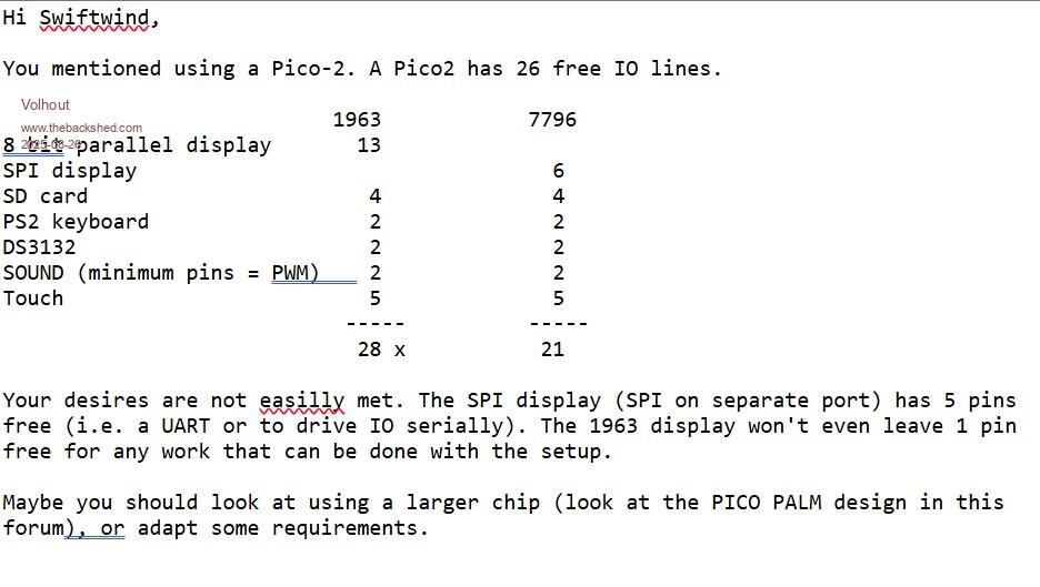

Hi Swiftwind,
P.S. On both designs, OPTION SYSTEM SPI could combine TOUCH and SD card, and thus save 3 pins. But I have no means to test if this works.

Hi Swiftwind,
Understood. So you have GP17 and GP28 free.
GP17 can be programmed as COM1:RX and GP28 can be programmed as COM1:TX.
So for expansion, you have a UART port free. That could allow for connecting a ESP8266 WIFI, or a GPS receiver, MAX3232 (genuine RS232 port) or MODBUS/RS485 expansion.
One thing you could do is:
GP26 I2C SDA
GP27 I2C SCL
GP20 PCM-A LEFT
GP21 PCM-B RIGHT
This would still leave GP17 and GP28 free, audio would use PWM2 channel, but I2C would map to I2C2 that you would connect to internal I2C devices like the RTC. Advantage of this new mapping is that GP17 and GP28 can be used as COM1, but also as I2C, since it is independent of I2C2.
So you could expand with Sparkfun Qwiic modules (all I2C based) or the like...
