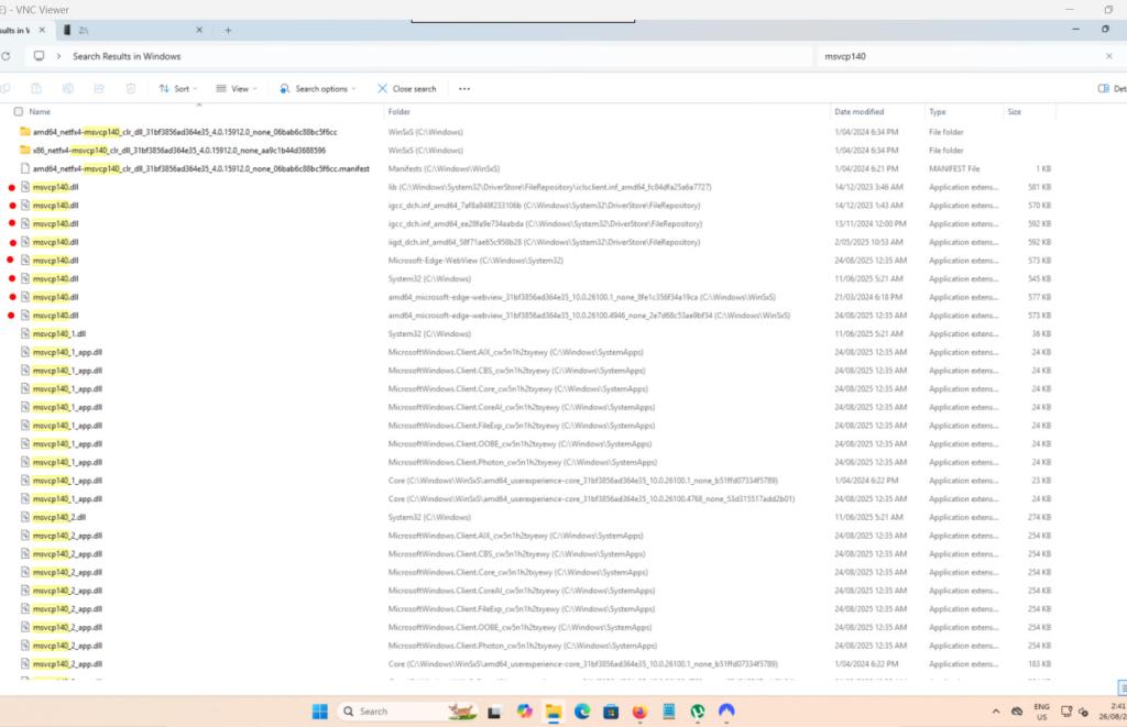

I searched for MSVCP14.DLL on my PC and found the DLL in at least 8 places (marked in RED on below screen cap) and many more derivatives of it on the PC
A search for VCRUNTIME.DLL shows 8 locations with the file and many more derivatives of it.

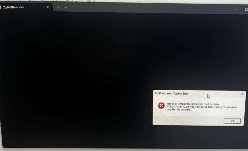

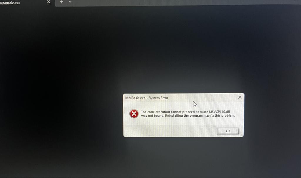

Its just that MMB4W will not run on my new W11 PC. I get the following error on running MMB4W
After clicking OK I get this error
Apologies for the bad quality, I couldnt screen capture as I run it through a VNC program so they are phone captures
*** EDIT
Sorry the images are the wrong order, I get the second image error first then the first error image
Mik
