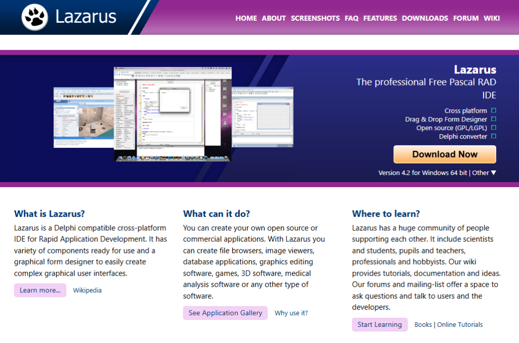

Hello
Like so many times, I stumbled upon something called "Lazarus".
What is Lazarus?
Lazarus is a Delphi compatible cross-platform IDE for Rapid Application Development. It has variety of components ready for use and a graphical form designer to easily create complex graphical user interfaces.
What can it do?
You can create your own open source or commercial applications. With Lazarus you can create file browsers, image viewers, database applications, graphics editing software, games, 3D software, medical analysis software or any other type of software.
... anyone who has tested or used it?
https://www.lazarus-ide.org/index.php

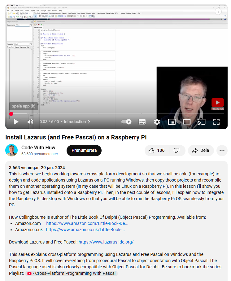

I've looked into it a bit more and, Yep, there's a lot on YouTube that shows how to use it, together with the Raspberry Pi.
Now Python is perhaps the language I usually use when programming on the Raspberry Pi, but it's interesting to have another IDE that you might be able to use (even if it's Pascal language).

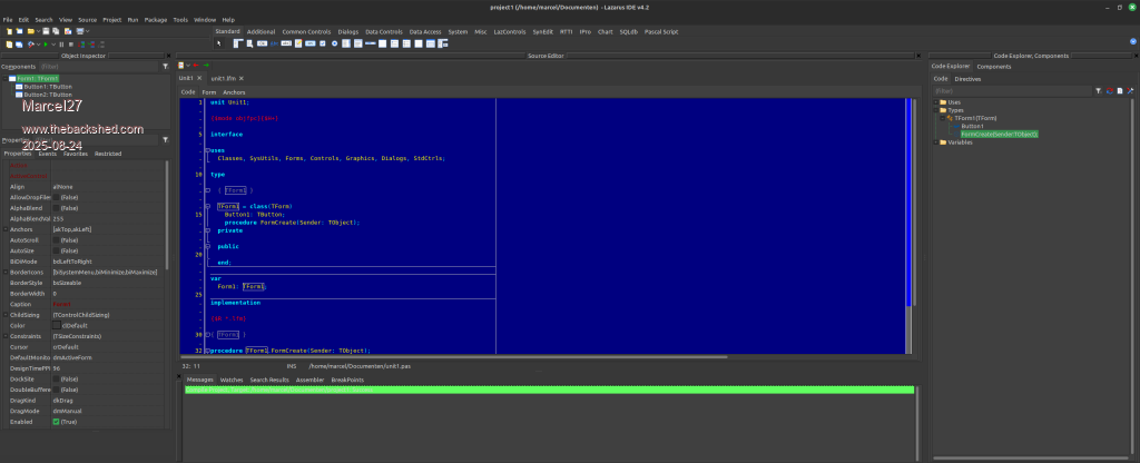

3 day's ago I have installed Lazarus (FreePascal) on my LInux Mint (LMDE6) distro. I'm still learning the IDE and the new overwhelming syntax again. The problem I have with the IDE is that it have scattered windows everywhere and they won't sick together.

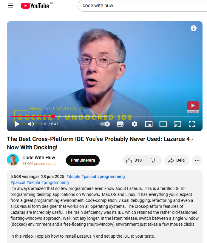

I found this video on YouTube...
/Peter63

I saw that my Linux distro had an old version of Lazarus 2.2.6+sfsg2-2 in it's programming source. I Uninstalled it and downloaded the latest version from the Lazarus website. It has besides the old one, a new IDE interface - single window just like Visual Basic. Now it more usable. In the past I dumped Lazarus because of the dull scattering and not docking windows.
Lazarus 4.2 (rev Unknown) FPC 3.2.2 x86_64-linux-gtk2
