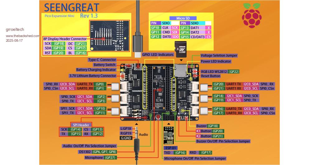

I have a Pico installed on a SeenGreat expansion board. The included SD card connector has defined pins, and there is a connector for a display that points to specific pins. Both use SPI, so I wonder, can two SPI buses be declared at the same time with OPTION SYSTEM?

No: but on 6.01.00 betas you can use OPTION LCD SPI for the LCD and OPTION SYSTEM SPI for the rest.

The SD card doesn't have to be on SYSTEM SPI either.
  Manual said  Dedicated I/O Pins
Alternatively, where no other devices share the SPI bus with the SD card it can be set up with:
OPTION SDCARD CS_pin, CLK_pin, MOSI_pin, MISO_pin
In this case the pins can be assigned completely flexibly and do not need to be capable of SPI operation but SD card performance will be better if valid SPI pins are chosen.
