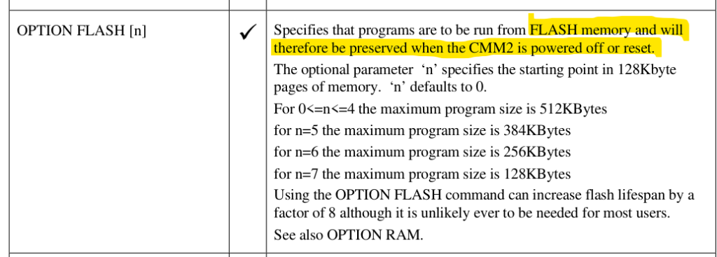

If you are using a CMM2 as a controller then on boot it will have to load your program from SD card, tokenize it then run it, it's not already there in flash.
This is something else that had me scratching my head:

I'd completely forgotten that. :)  Yes, definitely a possibility for a controller. With OPTION AUTORUN ON, once you've debugged it a bit. You have to tell it how much flash you are going to need, so develop your program in RAM first, then you can find its size.

  Mixtel90 said  I'd completely forgotten that. :)  Yes, definitely a possibility for a controller. With OPTION AUTORUN ON, once you've debugged it a bit. You have to tell it how much flash you are going to need, so develop your program in RAM first, then you can find its size.
Pretty sure I tried all that but it still insisted on having the SD card inserted. Might be typing through my posterior...I'll rig it up again to see what's up.
