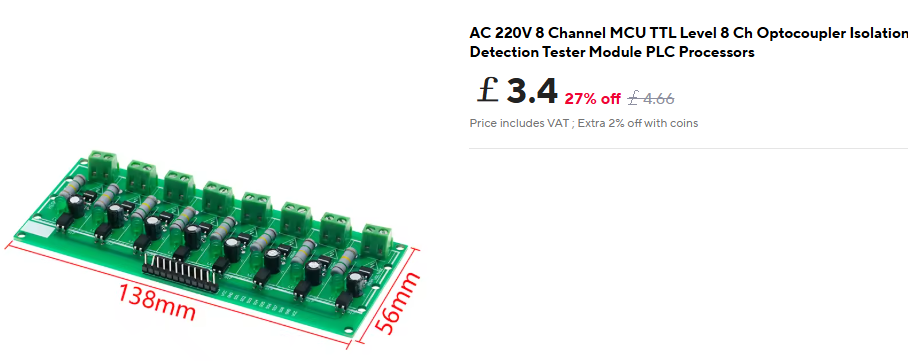

Went to help-out a new customer whose production was at a standstill. Big panic.
All they do is shot-blast and powder-coat metal structures. I'm getting more and more of these odd-ball jobs through word-of-mouth due to the skills-shortage I guess.
I cut my teeth (apprenticeship), building relay panels and this, like many I come across, was all relay logic. Piece of cake to figure the problem but the simplest fault puts these companies completely out-of-action due to the absence of diagnostics and trouble-shooting abilities.
Staring at this panel, all I could think about was: PicoMite-upgrade required.
However, the control circuitry is all 220V AC and I'd want the conversion to be as simple as possible. Outputs are no problem but there are a few inputs to deal with.
Then I remembered an impulse purchase that I made awhile ago on AE:
AC INPUT MODULE:
I know a guy who is constantly traveling the UK with his team, doing nothing but keeping these huge powder-coating ovens up and running and he commented to me that the biggest problem is the primitive relay panels, everything else is easily repairable.
The potential for relay-to-PicoMite upgrades for many types of machinery is mind boggling.

You'd think they'd put the resistors in all the same way round, that looks so untidy. :(
Can't get a decent PCB assembler now...  :(
The price is ok though. :)
The creepage distance under that big resistor could have been increased easily and at no cost.

  Mixtel90 said  You'd think they'd put the resistors in all the same way round, that looks so untidy. :(
I share the same OCD
If I absentmindedly solder-in a resistor that doesn't conform, out it comes

I have no data to prove it, but the opto input could be slower switching than mechanical relays.
Edited 2025-08-07 00:27 by Volhout
Posts: 9328
Posted: 02:38pm 06 Aug 2025
They bounce less though. :)
The "intelligent relay" controllers usually put something like 20ms delay on all inputs. Also, they scan the progran cyclically, which can introduce further delays.

  Volhout said  I have no data to prove it, but the opto input could be slower switching than mechanical relays.
Mechanical relays are quite slow and there's also zero crossover to consider.
This is primitive stuff but no excuse for no diagnostics in this day and age.
We can incorporate full documentation including a BOM showing alternative equivalents and suppliers etc.
