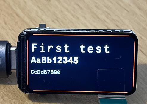

The display with the RP2350 intrigued me, so I bought one without pins. A computer-savvy colleague suggested it, and I recommended it in MMBasic. It worked for him. Now I've started testing it myself, and this is my first result.
Because the display has rounded corners, you can't draw right up to the edge. The image is perfectly sharp. Unfortunately, I can't capture it any better in a photo. Loading files also worked for my colleague, and he was able to display .jpg files.
According to the description, the RP also has a built-in temperature sensor and a clock. I still need to test those features and image loading. But I'm very happy with my initial results.

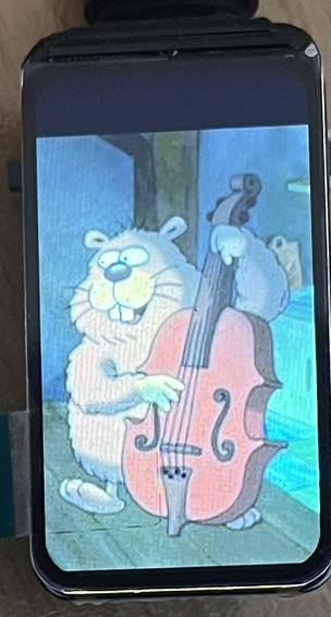

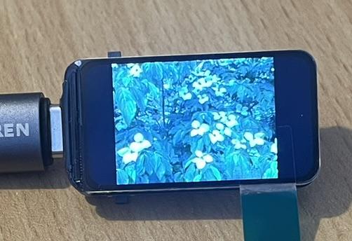

Images are very easy to import. The quality is very good. I didn't expect that. The image format must be N x 172, where N cannot be larger than 320. Using `<load jpg "name.jpg", X, 34>`, you can get the image to fill the screen completely, both top and bottom. X is 40 for my image format, so it's nicely centered on the display.
The GPIO for the RGB LED is 22. Since the LCD frame is transparent, the light is diffused all around. It looks good. However, the colors are reversed. I haven't figured out why yet.
I couldn't find any I2C pinout in the schematic. Presumably, you can't read a clock or a temperature sensor. I have no idea what the manufacturer was thinking with that description. I also can't find a GPIO for a one-wire connection.
The photos don't do the image quality justice. Please keep that in mind.

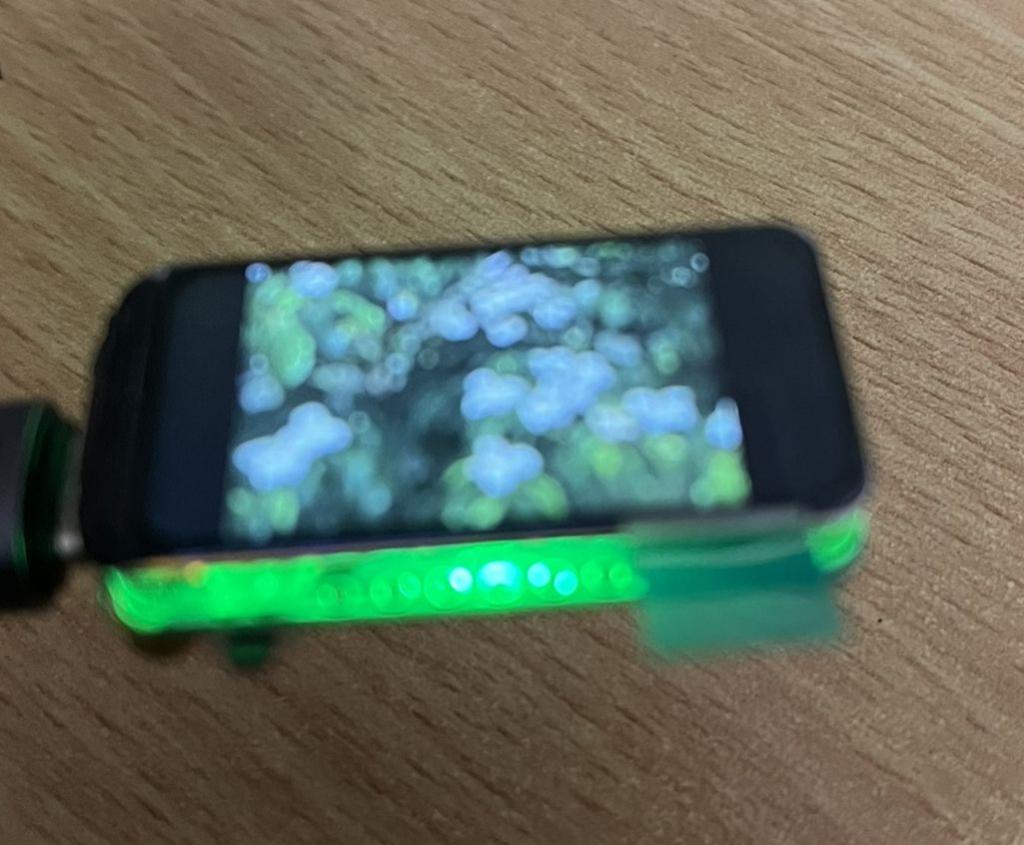

Posted: 10:19am 31 Jan 2026
No, the light doesn't shine through the display. It's only visible at the edges. It's noticeable that the color numbers don't correspond to standard LEDs. For example, RGB (red) produces green, RGB (green) produces red, but RGB (blue) produces blue.
Sorry about the poor photo quality. I wanted to show the entire light.
Best wishes! Joachim
Posts: 9328
Posted: 10:29am 31 Jan 2026
This colour difference is the same on the YD-RP2040. It seems to be a different variation of the WS2812 than we are normally used to. Easy enough to work round once you are aware of it.

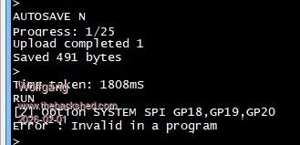

I also bought this little toy, but I'm having trouble getting your little programme to run. I installed  this version
on the small module and loaded your programme, enabling the options in your programme.
But the display remains dark. Only this error is displayed
As I am not yet very familiar with this, I am asking what I did wrong.
Could you help? showing your complete functional programm to display your or other Text?
Wolfgang

I could be wrong but aren't some of those options only supposed to be issued at the command prompt?
Listed in the program for reference?
v.lenzer
Joined: 04/05/2024
Posts: 157
Posted: 10:09am 01 Feb 2026
Hi Wolfgang!
The options you see in the listing are just comments. You have to enter the options directly in the console.
The program is attached. It also makes the LED light up. I've commented out the image loading.
