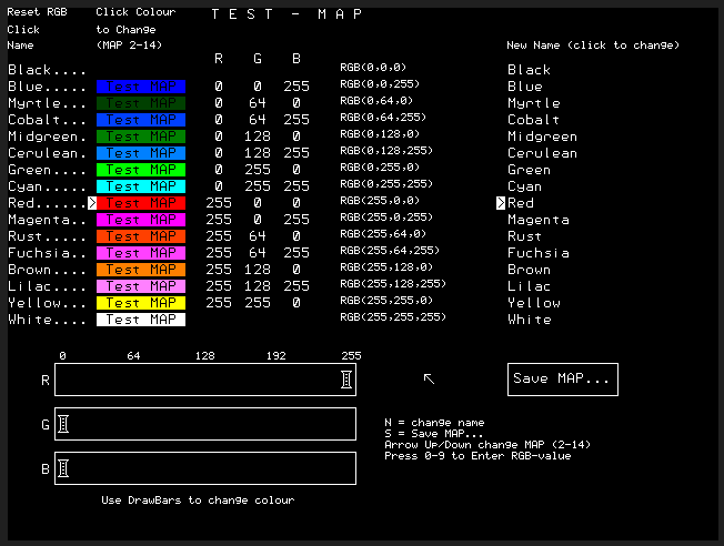

RGB colors are quite interesting when you look at them more closely.
I have made a program that makes it a little easier to make your own "MAP" files. The program is useful as it is today, but there are probably things that could be done differently. I'll leave it as it is today to see what kind of comments there will be.
The program is written for PicoMiteHDMI MMBasic USB RP2350A Edition V6.00.03
and uses mouse and keyboard.
CTRL+C to exit the program
test-map.zip
/Peter63

The program is written for 640x480 HDMI (Mode 3), I forgot to mention this.
But should work on VGA 640x480
Choosing the right color can sometimes be crucial in how you experience a program or application. I was a little interested in using "DrawBars" to set the RGB values, thinking that this should be easy and cool. You get a different feeling of what happens to the color when changing the value with "DrawBars". But you can also type the values directly.
I had to lock White and Black, otherwise it would not be possible to read the program text on the screen.
/Peter63
