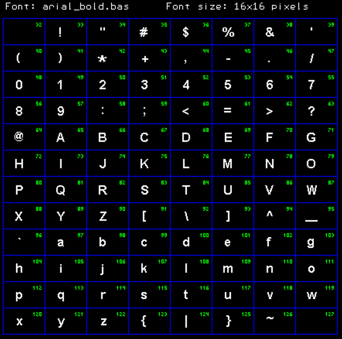

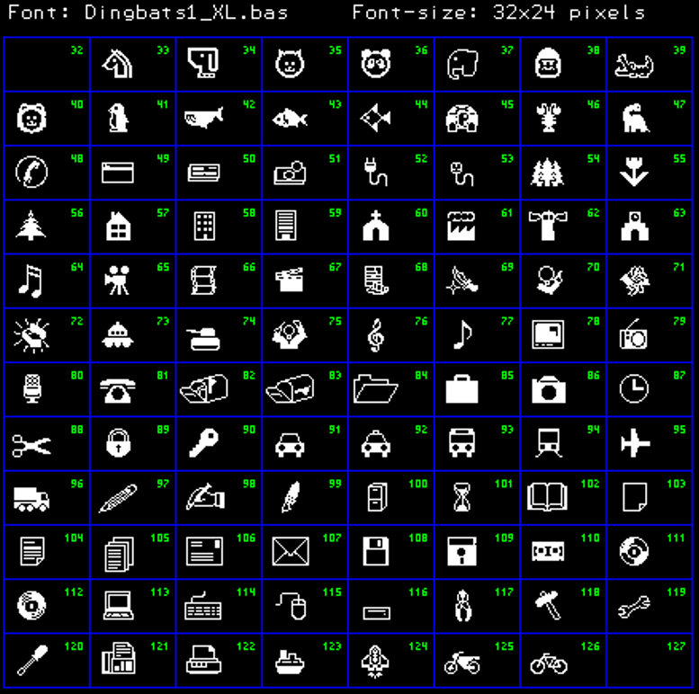

I've looked a bit at the fonts that come with the firmware download. I thought the font "Dingbats1_XL" seemed interesting, I made a program that printed the font on the screen (see below). PicoMite firmware V6.00.03
Here is the program that prints the font on the screen.
Dingbats1_XL.zip
/Peter63

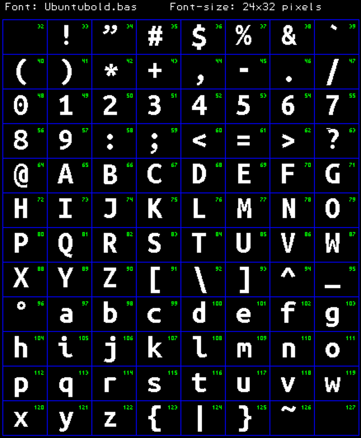

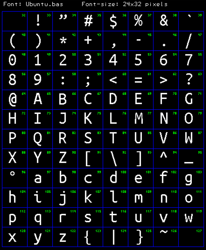

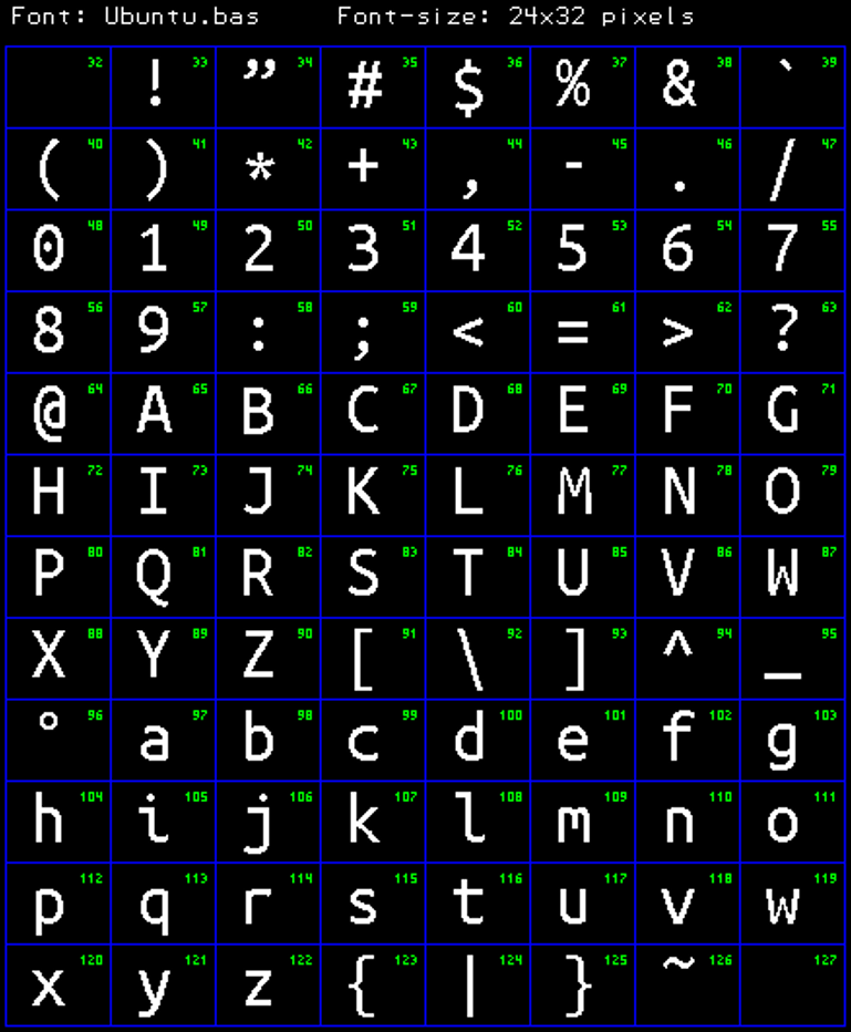

I have looked at the font "Ubuntu.bas" and found a small "error", char 123 is not correct.
I have adjusted this with the program FontTweak which is also included when you download the PicoMite firmware. I am sending an adjusted file here.
Ubuntu-fixed.zip
/Peter63

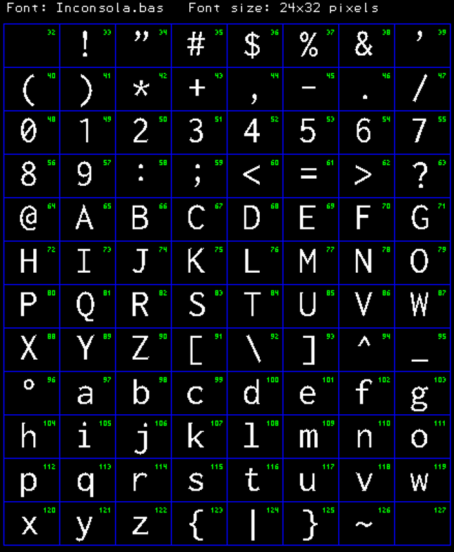

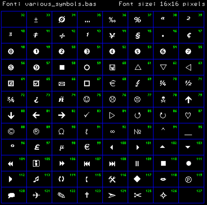

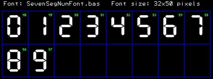

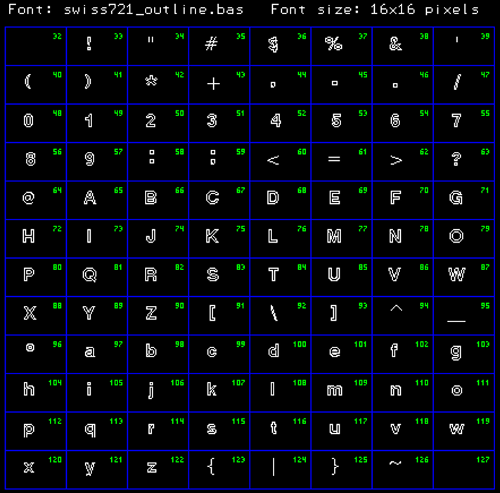

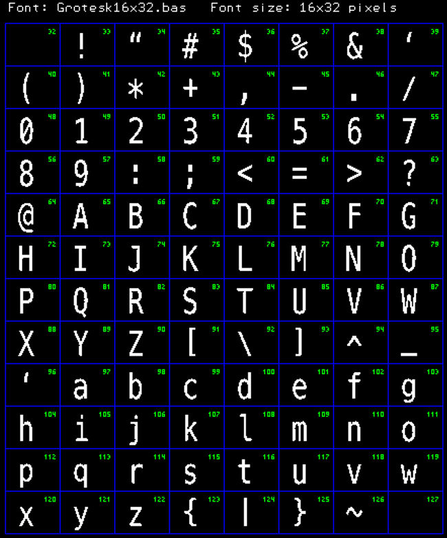

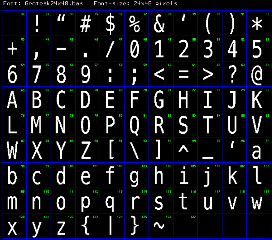

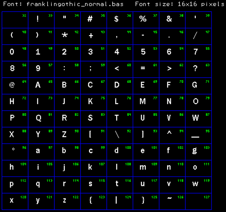

I have a few more, but that's all I've looked at for now. Here they are...
/Peter63

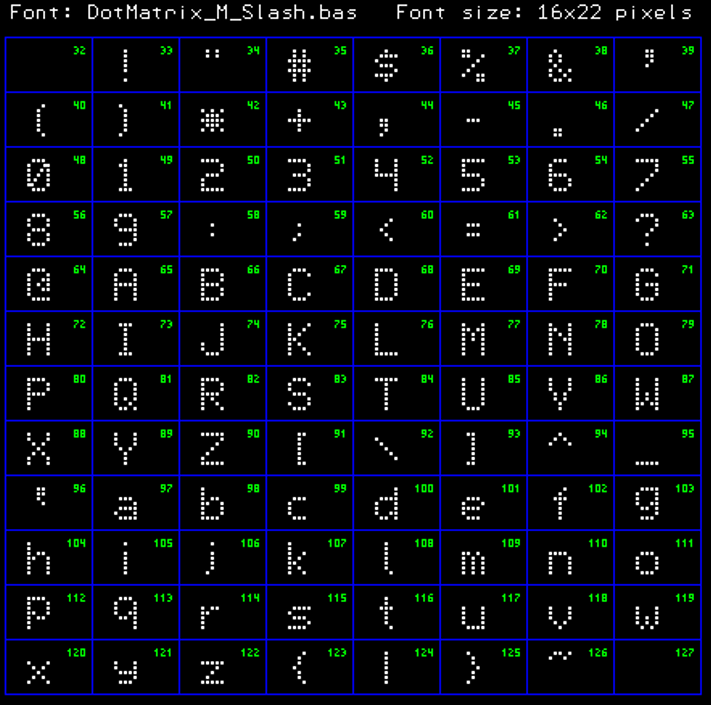

One more font "DotMatrix_M_Slash.bas" , look like this...
/Peter63

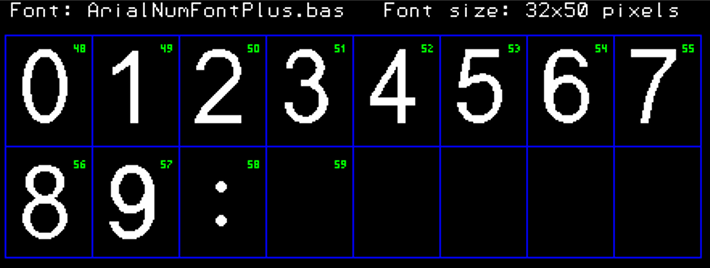

Posted: 11:19am 30 Jul 2025
Here are two more fonts...
/Peter63

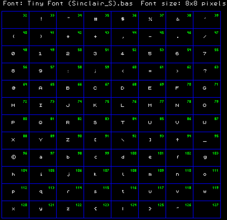

Posted: 12:14pm 30 Jul 2025
More fonts...
/Peter63

Posted: 01:23pm 30 Jul 2025
Some more fonts...
/Peter63

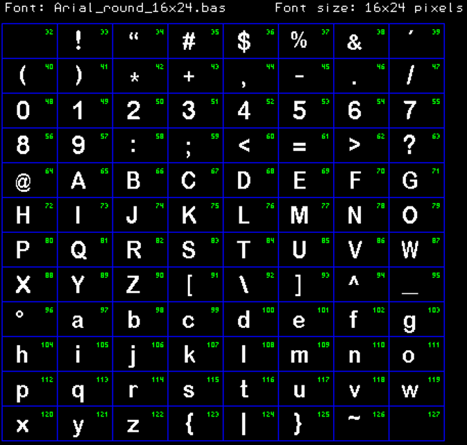

Peter63
Please can you post the arial-round 16x24 font - thanks
Peter63
Joined: 28/07/2017
Location: Sweden
Posts: 220
Posted: 02:08pm 30 Jul 2025
Here comes the font. The program for printing is at the beginning.
Arial_round_16x24.zip
