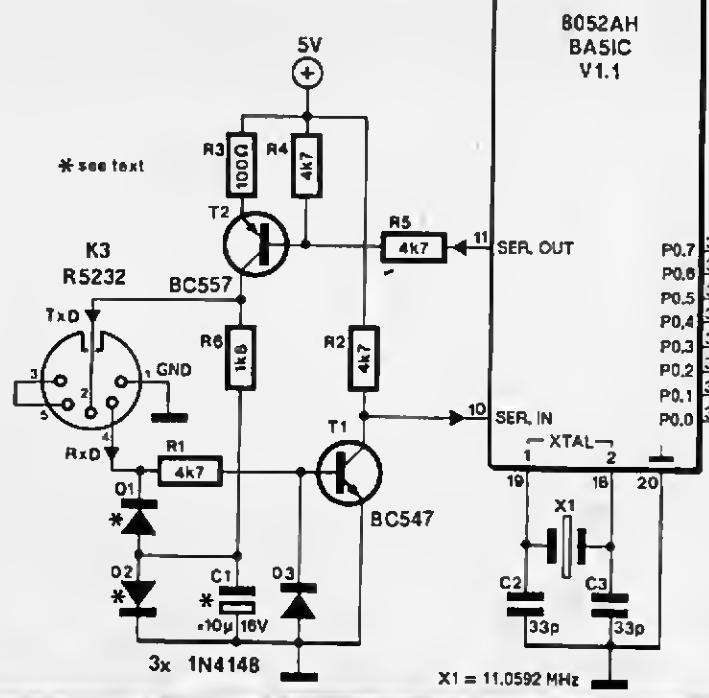

Long-long ago (1987/11) the ELEKTOR magazine published an interesting project with the 8052AH-BASIC microcontroller..
Very clever in the schematics: A cheap RS232 interface without IC (MAX etc.):
Used it several times in other applications.
BUT: it only works, if the remote has a full RS232 !
bfwolf
