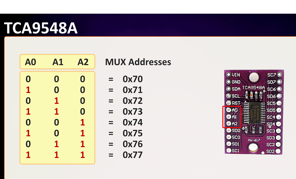

dunno if a0 to a2 are hardwired or go to gp pins.
Posts: 6253
Posted: 03:35pm 29 Jul 2025
Easy, connect the module to your desired I2C bus, and run an I2C scan. From the address found you know the wiring.
stanleyella
Joined: 25/06/2022
Posts: 2807
Posted: 07:39pm 29 Jul 2025
this is just the devices i2c addresses itself which can be 0x70 to 0x77. mines in the post. solder it up and post

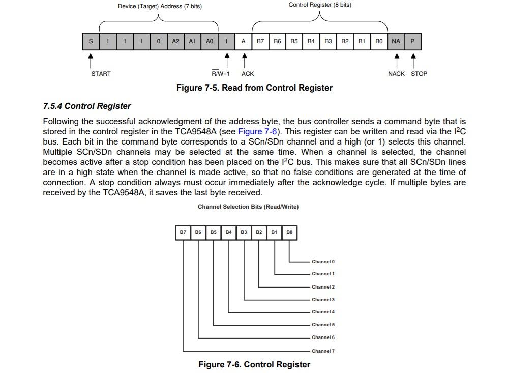

I don't get this. the tca has address so writing 2 bytes to it to set up a device and the register so what channel conected to for each device
Posts: 9328
Posted: 09:21pm 31 Jul 2025
It's easy enough.
You are sending one byte (B7-B0) to the address of the TCA.
The TCA address is [0]1110[A2][A1][A0] - that's 70 to 77 depending on the address pins.
The next bit is 0 to read from it or 1 to write to it. You are selecting a device, so this will be a 1 so that you can write to the device select strobe.
The next 8 bits after the ACK (which is automatic) are the device strobes, one per I2C port. So a 1 on B0 will select port 0, a 1 on B1 will select port 1 etc. All non-used ports have their strobes set to 0.
It's possible to select two I2C ports at the same time (not sensible for many devices) by setting both their strobe bits high.

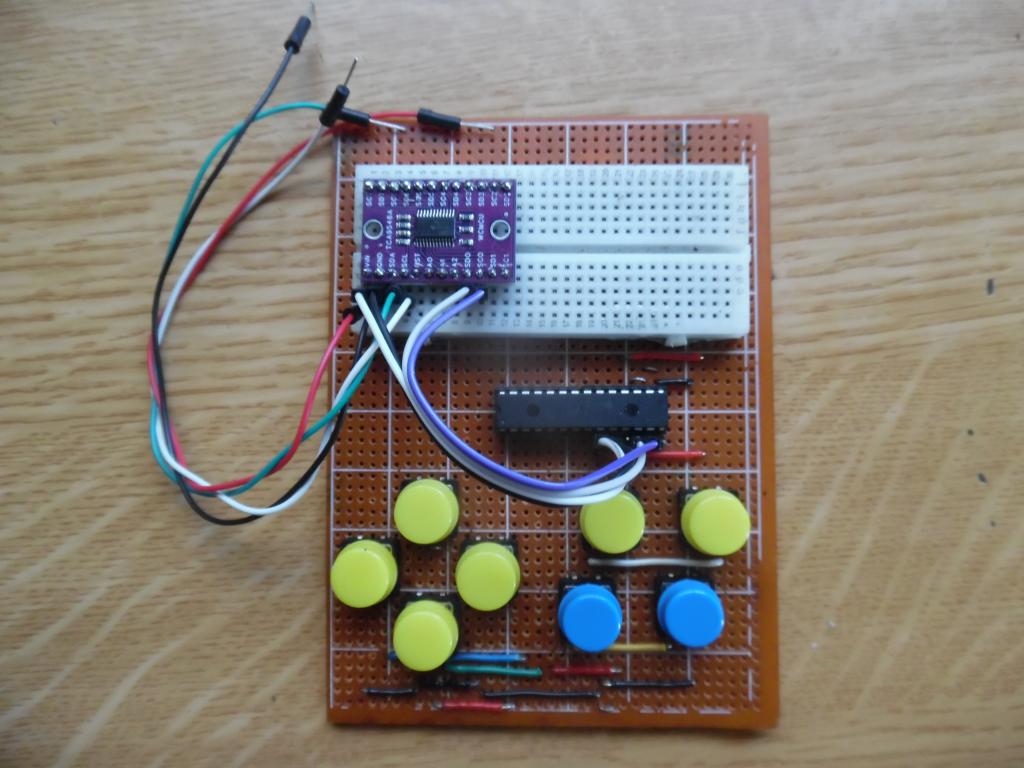

I not knocking the device but admit I don't use i2c. all were experimental and the 16 channel gpio was great but who else got one and the laser rangefinder was brill connected to i2c oled. no mux needed. got so far and lost interest with device

Posted: 09:30pm 02 Aug 2025
this has 16 io and you could have 8 devices and you can have 8 tca so (16*8)*8=1024 io for whatever
