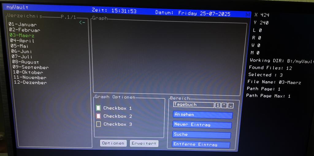

I am working on a "journal / diary" application with graph stats and so on... this is why I was in need of sorting it and don't care about file properties:
Greetings

Thanks to your hint with Vadims FM, I sucessfully cut out the code snippet and it works AS is in this example (only for DIR, of course). But I implemented it already in my program, the crucial hint from you, was the SORT command I wasn't aware of. I already adapted it in my program, since it was only one line to add!
