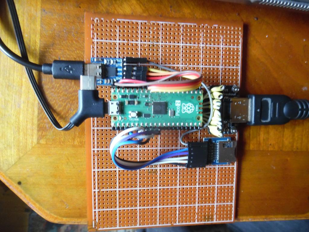

stanleyella
Joined: 25/06/2022
Posts: 2807
Posted: 04:39pm 24 Jul 2025
sorry Mick, just showing usb to ttl one side of pico and sd card other. sd card needs 3.3V supply I wired from usb to ttl.
I reset the com pins and sd card pins from manual.
Roy should use non usb first try maybe and mmedit and mmcc via win pc
and default pins in the manual
