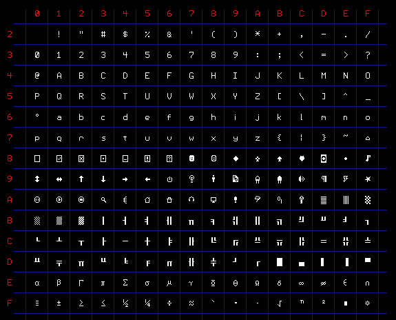

Using font 1, chr$(&h92) to chr$(&h95)
https://www.thebackshed.com/forum/ViewTopic.php?FID=16&TID=18132#242212
Peter63
Joined: 28/07/2017
Location: Sweden
Posts: 220
Posted: 05:06am 22 Jul 2025
Font1 table here:

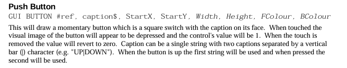

According to the manual, the button works like this:
