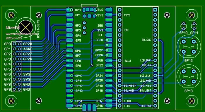

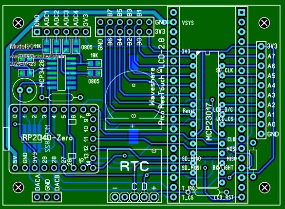

I designed a couple of little backpacks for it a while ago, so it is possible to do things with them. I never actually made either of these. :)

*Nothing* supports MMBasic officially apart from what you find in this forum.  :(  Probably because Raspberry Pi don't recognise MMBasic as one of the official languages for anything.

Nice job Mixtel!  I really like the second one with extra I/O, RTC and data converters.  Nice work.  An amazing group here.
