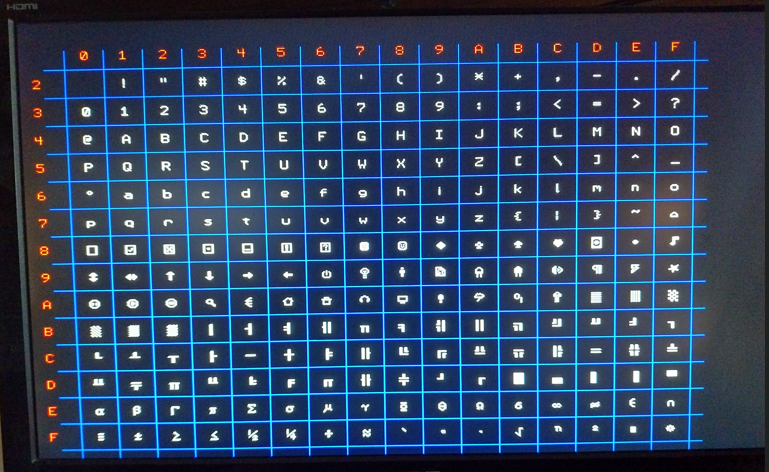

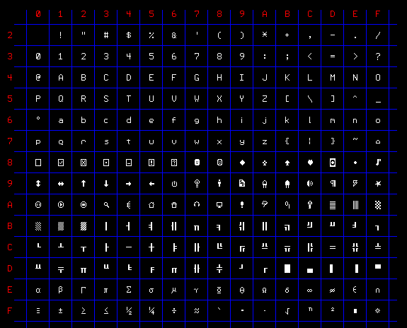

The manual shows a table but unfortunately does not show which hex code the character has, this program shows this.
There are many characters I did not think of but that are there, such as "light bulb" = hex 97 or "SD-card" = hex 99
Is it a house on hex A5 or are it headphones on hex A7

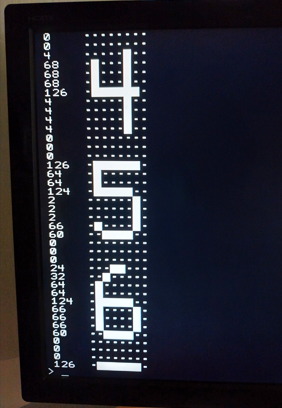

You can also print the entire FONT1 as it appears in memory. See attached program. I use MM.INFO(FONT ADDRESS 1) to find the start of FONT1.
font1.zip
/Peter63

This is what the program font1.bas looks like, where you can see the DEC code on the left. Each character in FONT1 is 8 x 12 (width x height).
font1.zip
/Peter63
