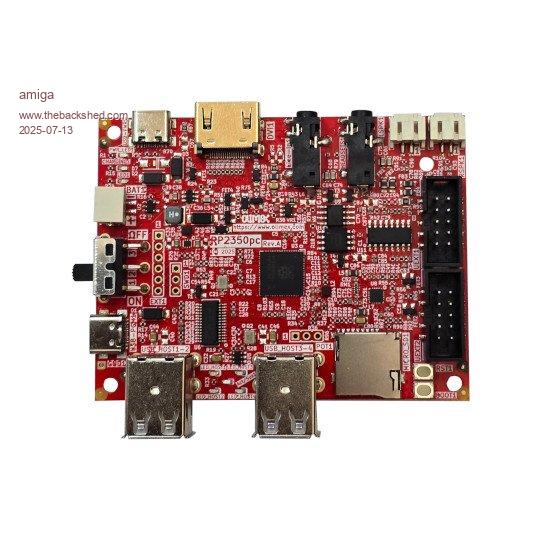

i all folks,
there is a new board for PicoMit cost +/- 25€ .. without tax and transport !
https://www.olimex.com/Products/RaspberryPi/PICO/RP2350pc/open-source-hardware
have nice day or sleepy night,
amiga
Posts: 9328
Posted: 07:02am 13 Jul 2025
I've just been having a look at the circuit - probably one of their better efforts. They've used GP8 for PSRAM select but then lost two of the ADC pins by using them internally anyway. :(  Do these people not realize that having the availability of 8 ADC inputs is actually a "big thing" for this sort of board? By all means bring out the battery voltage and external power detect to pins - the user can decide whether or not they need monitoring.
The power supply looks like the RPi recommended switcher, I wonder if they've got it right and this thing will overclock? What's the betting that it reaches the RPi spec and not much further?

Has anybody got MMbasic working on this board?
I have installed the firmware file PicoMiteHDMIUSBV6.00.03.uf2 on it.
It does start and prints a "P" to the top left corner of a connected HMI screen, but then hangs.
Posts: 3429
Posted: 11:08pm 26 Sep 2025
Welcome to the forum.
Perhaps it is starting to print the PicoMite version info.
Have you been able to set up the serial console?
If so you can see if it is the Pico that hangs or the HDMI screen not being compatible.
Others have had to try different screens to find one that works properly with the DVI-D over HDMI from the Pico.
If you don't have the serial console working install the non-USB firmware so you will have the USB console available to diagnose the problem.
Later you can install PicoMiteHDMIUSBV6.01.00b15 from the "PicoMite V6.01.00 betas" thread. It has a number of bug fixes.
olav
Joined: 05/07/2025
Posts: 3
Posted: 07:13am 27 Sep 2025
Hi, I‘ve got an answer on Github - thank you.
…but based on a very quick look they are using GP8 as the PSRAM chip select. By default the USB versions assume there is a serial console on GP8/GP9. If my assumption is correct, as soon as MMBasic outputs the copyright message on GP8 it is going to select the PSRAM and corrupt the QSPI bus.
I can't think of a way round this without you compiling a variant with the serial console changed to another pin. You would do this in the function ResetOptions in fileio.c. Make sure you clear the flash before trying to install the firmware variant.
All other boards I've seen put the PSRAM select on either GP0 or GP47 so this one is an oddity
I will try to recompile and report back here
