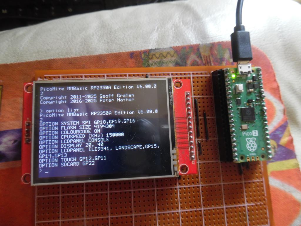

I tried a ili9341 board I built and upgraded to pico2 but no display so upgraded to v6.02 and set options but no display. swapped display, same. reflashed and heartbeat flashing but same. Then I realised I put the pico board wrong way round.
amazed pico not damaged. how to waste hours :)

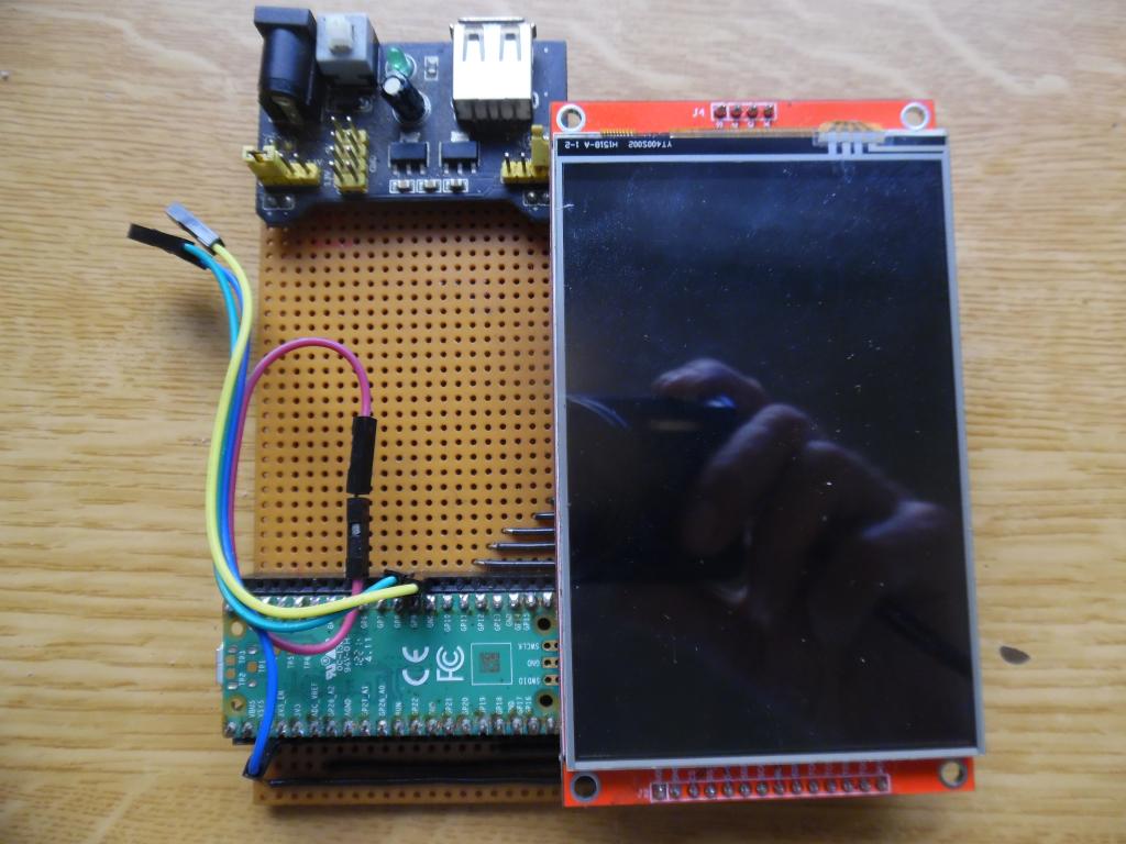

I did a ili bigger display but wired the pico upside down so I could see the gpio labels.2040  silly.
got to wire diode and resistor for it to work touch and sd card which I done but not on above board and it doesn't mess with ili9341

the above board 2040 I decided to update to latest firmware and took the board which was usb and pressed the boot button and then plugged the usb cable. windows went bing bong then the pico board got too hot to hold.
guess it was still in usb mode.
and looking at the above display it has diode sdo -->:--tp0
and 10KR cs---[10k]---tp0 which isn't mentioned in the manual so is it still needed?
the burning out pico is strange if it still in usb then no apply usb lead but I pressed the boot button

  Quote  and looking at the above display it has diode sdo -->:--tp0
? tp0 ? I assume you mean T_DO which is Touch_DataOut and goes to Pico MISO.
For an ILI9488 the diode and resistor are still needed for Blit, Image Save etc. As you have noted if they are fitted an ILI9341 will still work properly.
As for the burning out Pico that sounds like reverse polarity or excessive voltage on the 3.3V supply.
Perhaps for USB versions it may be better to unplug the Pico from the board before updating the firmware. That way there can be no conflict with external voltage supply.

The Boot button goes to the flash chip so pressing that doesn't have any effect on the RP2350. The data from the USB goes into the RP2350 and, yes, you do program even a USB Pico in the same way, over USB and using the Boot button. In fact, it's the only way. :)
If the Pico got hot it was for some other reason than programming it.

The pico is 2040 and mounted upside down to usual and had to remove it to access boot button. it was usb version and pressed boot button then connected usb lead to win pc, it created the pico drive for flashing but pico got hot around usb socket.
the usb pc lead is fine.
what would happen if connect powered usb from pc to usb pico?
Posts: 9136
Posted: 02:53pm 11 Jul 2025
Yes, you can use the PC supply. In fact, that's the right way - you should disconnect any other supplies while flashing the chip. You don't know if there's a ground voltage difference between the PC and your external supply.

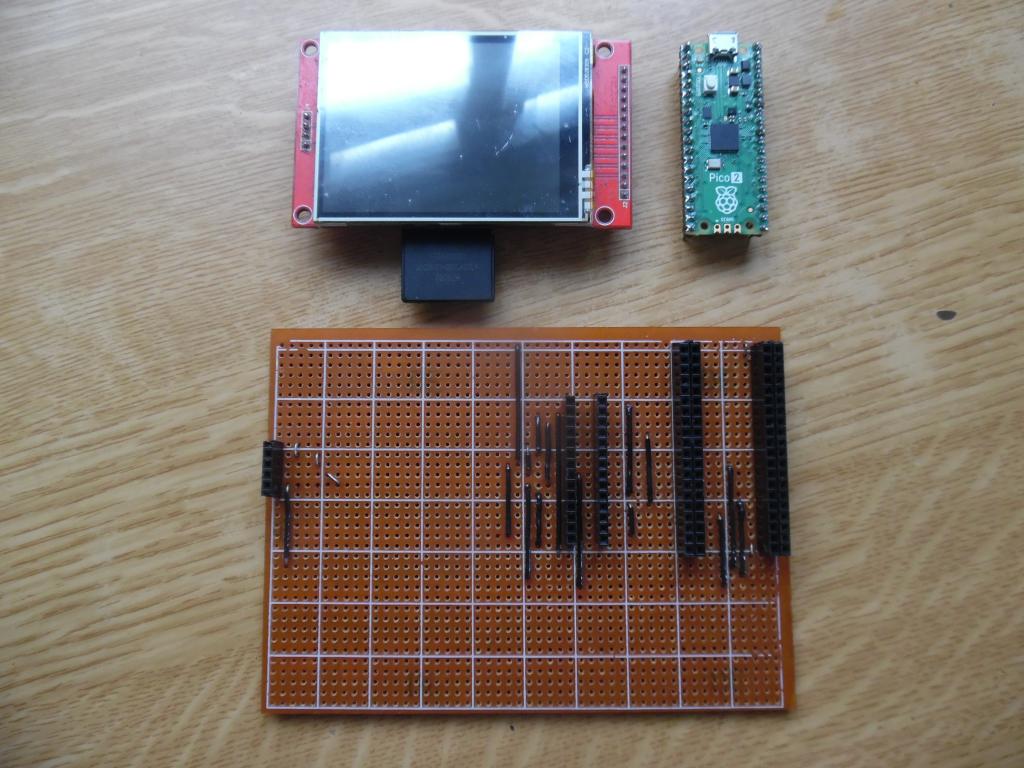

  Volhout said  Hi Stan,
I like you double row sockets for the pico. That saves board estate, and is very easy to implement.
I used 2 20 pin sockets but also used dual 20 pin sockets. 80 solder pins.
I use headers so I can wire under pico but would not solder pico as not easy to remove.
I not pcb user, it strip board, it does work :)
