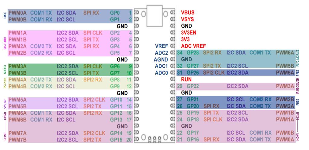

This is my Pinout idea:
Are there any problems (conflicts) so far?
With this design I still have 5 pins free
GP26 (ADC!!)
GP20
GP21
GP0
GP1
since GP20 & GP21 can do COM2 & give me a second I2C + PWM
and GP0 & GP1 can do COM1, I am quite happy with it.
