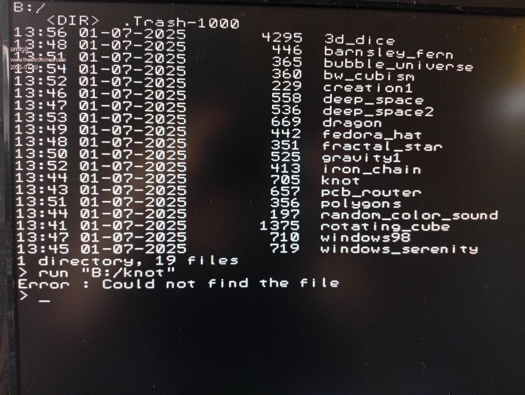

hi,
very stupid ... question ..
i have several prog. on SDCARD .
with FILES , all files are listed .
in mode command : RUN "B:/knot"
error ...
i think i make something very stupid .. but wich of them ?
thanks ,
Amiga ( from boiling Belgium .. hot .. hot ..)
Posts: 6253
Posted: 02:45pm 01 Jul 2025
Hi Amiga,
The files in you SD card do not have the suffix ".bas"
Maybe you could try to put the card in a PC, and rename the file to "knot.bas" and then try again.

It's looking for "B:/knot.BAS" and that file isn't there. :)
By default MMBasic will look for files with the BAS extension unless you specify something else.

try
COPY "knot" TO "knot.BAS"
