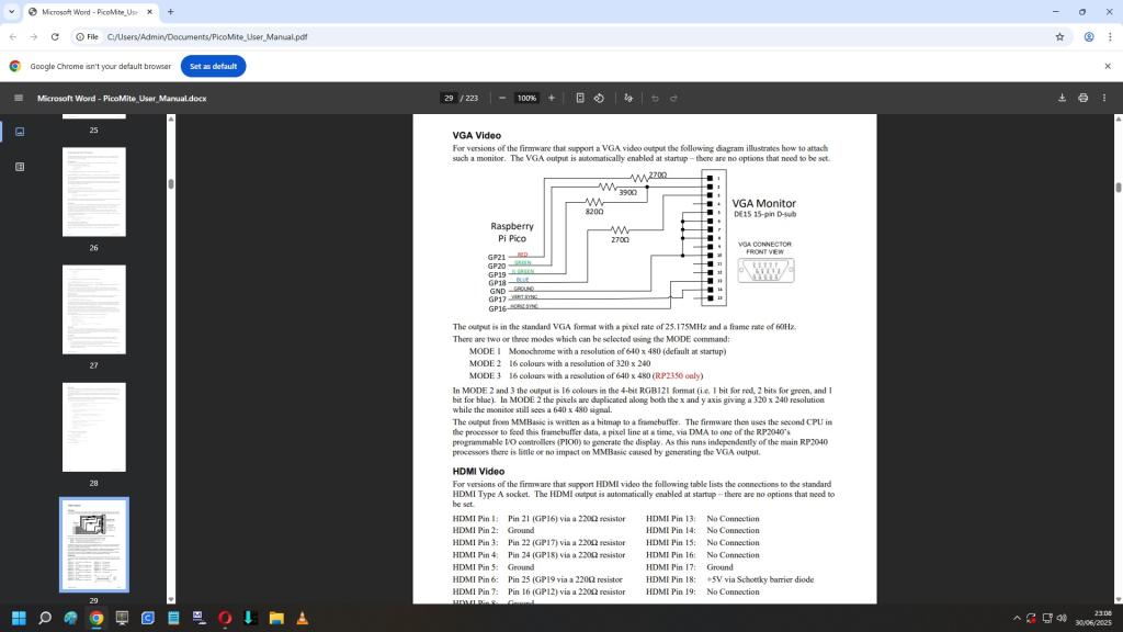

the manual resistors match the vga colours. have I got wots this is about wrong?
Posts: 3429
Posted: 10:47pm 30 Jun 2025

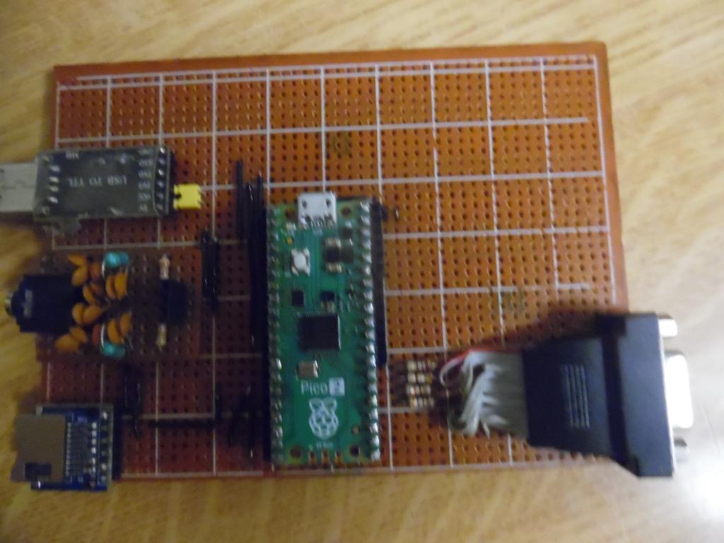

Your picture shows the Pico pins connected directly to the VGA socket. That will overload the Pico and may damage it. The resistors are needed to limit the current.

As Phil says, the resistors are needed to limit the current, but they do more than that. They act as a resistive mixer for green, allowing up to three green levels plus off. The four "colour" pins then act as a binary value to give 15 colours plus black.

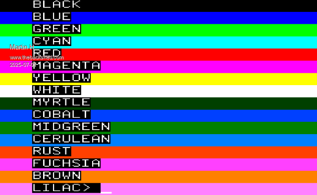

  tenij000 said
is there a program to test te colors
Mode 2
Dim Col(15) As Integer :Restore colors:For f=1 To 15:Read Col(f):Next
CLS :For f=0 to 15:read c$
Box 0,f*15,320,16,,Col(f),Col(f)
Text 32,f*15,c$
next
colors:
'--Colorscheme accordung to Spritecolors
Data RGB(BLUE),RGB(GREEN),RGB(CYAN),RGB(RED)
Data RGB(MAGENTA),RGB(YELLOW),RGB(WHITE),RGB(MYRTLE)
Data RGB(COBALT) ,RGB(MIDGREEN),RGB(CERULEAN),RGB(RUST)
Data RGB(FUCHSIA),RGB(BROWN),RGB(LILAC)
Data "BLACK","BLUE","GREEN","CYAN","RED"
Data "MAGENTA","YELLOW","WHITE","MYRTLE"
Data "COBALT" ,"MIDGREEN","CERULEAN","RUST"
Data "FUCHSIA","BROWN","LILAC"
Edited 2025-07-01 20:30 by Martin H.
'no comment

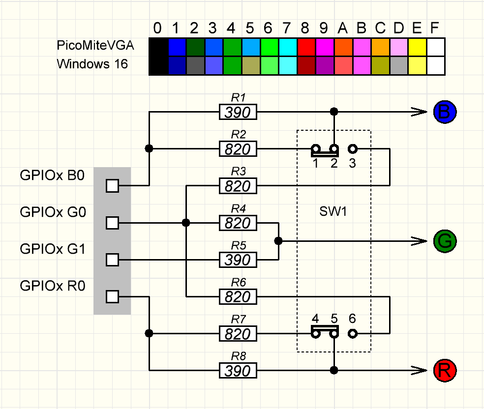

@tenij000

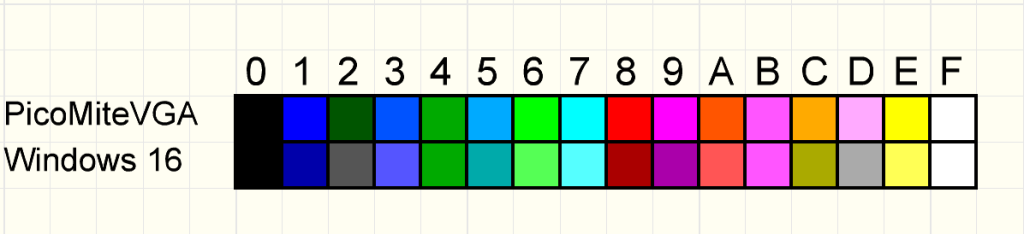

For the VGA video output of the PicoMite, you can make a resistor switch to switch between two 16-color palettes.
I think that even the Windows palette is even more applicable in practice due to the two shades of gray.

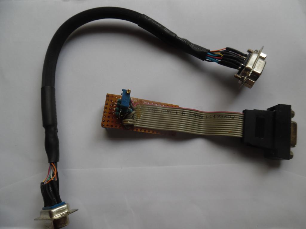

it's just not strip board friendly. my first vga when a multi turn pot was in the circuit but I posted adjusting it did nothing and it was removed.
cheap vga lead from ebay just for the sockets.

Posted: 03:14pm 01 Jul 2025
Interesting, Javavi. That's not the same diagram that you posted last time. R6 went to G1, not G0. It looks like the correction fairy has been round to visit. :)
A couple of things I don't like about the Windows colours is that 5 & C are very similar and orange is missing. It certainly has its uses though.

Posted: 04:38pm 01 Jul 2025
  Mixtel90 said  Interesting, Javavi. That's not the same diagram that you posted last time. R6 went to G1, not G0. It looks like the correction fairy has been round to visit. :)
Hi Mick,
Yes, there was a mistake in the previous diagram, I corrected the diagram here.
And also corrected color 5 in the color chart, this seems to be correct:
Posts: 9328
Posted: 06:08pm 01 Jul 2025
Thanks. That looks a lot better. :)
I'm just using your switching scheme on my Multi2 design.  :)
