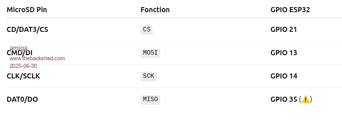

Hi,
anybody use this card from Olimex ESP32-SBC-FabGL .
I try to run PCEmulator on it , but SDCARD not found and GPIO for the SDCARD is not the same than lillygo TTGO esp32 VGA .

   From the circuit diagram for the Olimex module:
CS         GPIO 13
MOSI       GPIO 12
CLK        GPIO 14
MISO       GPIO 35
Hope this helps.
Link to the circuit digram,
https://github.com/OLIMEX/ESP32-SBC-FabGL/blob/main/HARDWARE/Hardware-revision-B/ESP32-SBC-FabGL_Rev_B.pdf

IT WORKS now .. oufti
Ex deus Machina .. hardware is very very subtile ... buy another sdcard (philips 32GB .. and magic FabGL PCemulator found it , format and install from menu Windows .. 3.00
Works nicely  ..
And this without change original code .. run on Olimex ESP32-SBC-FABGL and on TTGO VGA 1.4
