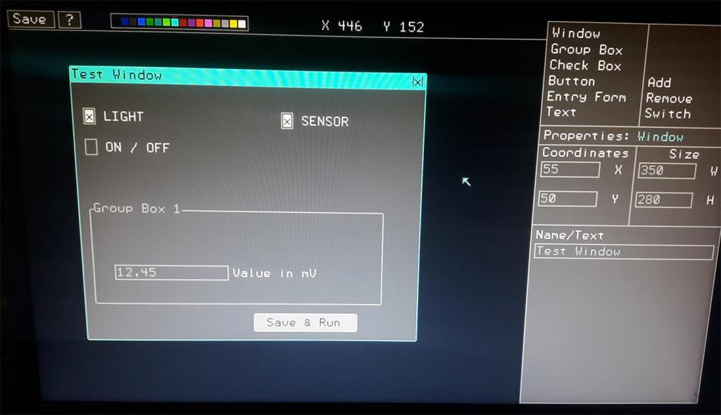

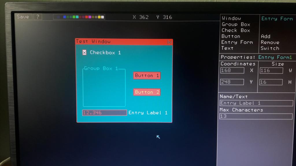

Hello all,
since I need some GUIs for my project all the time, I was tired to start every single time at zero. So I thought: "well let's SIMPLY write a program for that"... uhm.. easier thought than done. My editor is still in beta (obviously!) but as it turns out: it works really really well and saves me a lot of time.
First some pictures:
A few words on my setup (see pictures)... I often said this many times. I am not happy with the colour palette of the VGA version, since it is missing grey. On my own designed PCB I made it switchable via jumpers, so you can choose between standard picoVGA and a pseudo windows 95 16 colour palette. In another thread I posted a schematic of exactly this PCB. So I designed this editor around my "grey" mod. So if it hurts your eyes for the standard picoVGA, just change them in the code!
The second point is: At the moment it is designed for:
Resolution 720 and Mode 3... Maybe I will add more modes later on...
I use it with PS/2 mouse and keybaord. Maybe for USB you must adjust the code!
What can you do with it? Well.. At this moment in time, you can:
- create one window
- add "items":
- Checkboxes
- GroupBoxes
- Buttons
- Entry Form
- Edit its height & width and set coordinates
- Change colours of every item (foreground, background, text)
- Finally: save the whole GUI / window with mouse integration as a *.bas

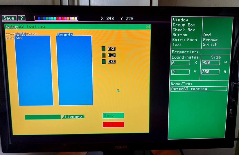

Posted: 02:42am 29 Jun 2025
Hello Daniel
Seems like a good idea, even for VGA mode. Good job according to the pictures. I haven't had the time to check the program. But I can only understand that there is someone who has put in a lot of effort into the coding.
/Peter63

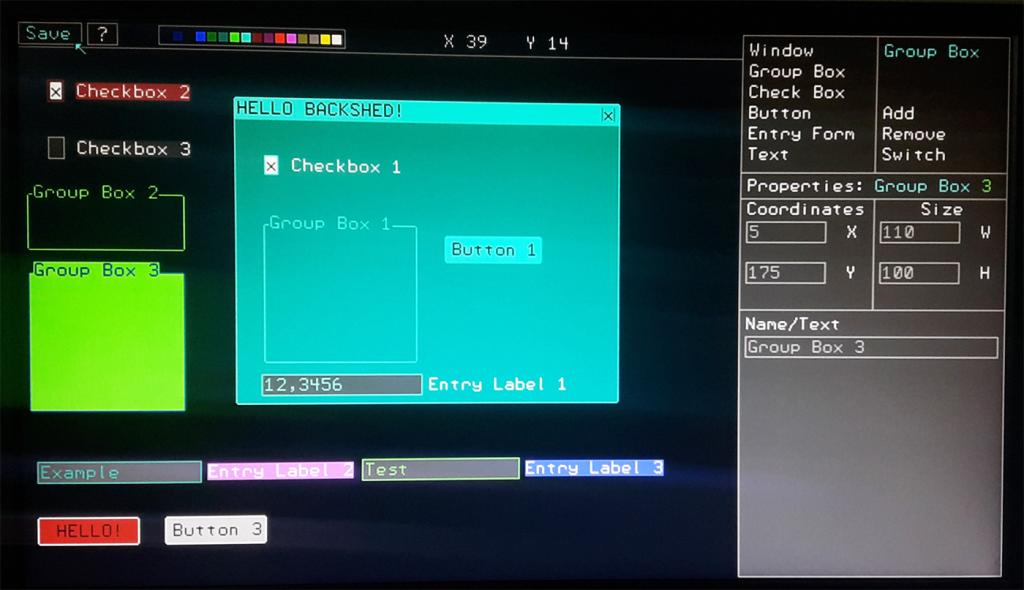

Small update:
- fixed bug in button item, now it is possible to change the text colour (middle mouse)
- rearranged code in subroutines, MAIN LOOP is now clean
- small fixes in mouse routine
- Acknowledgements added (Michael & Peter)
Next update will be:
- more items
- allowing more than three items each
- entry form will have more editing options (eg. allowing only numbers as input & input length)
gui_editor_b21a.zip

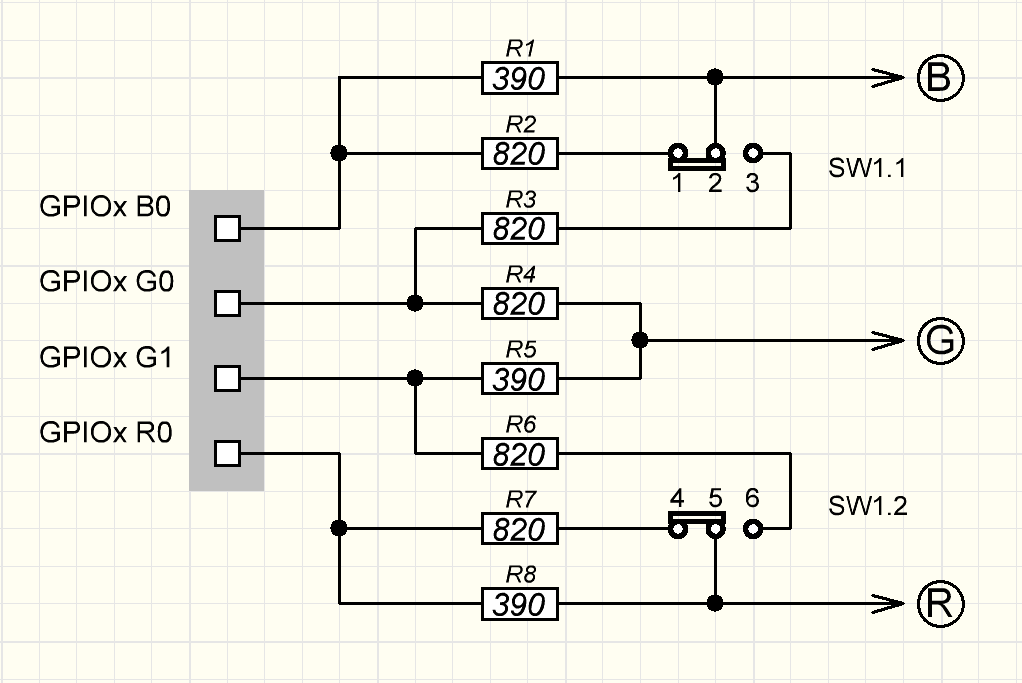

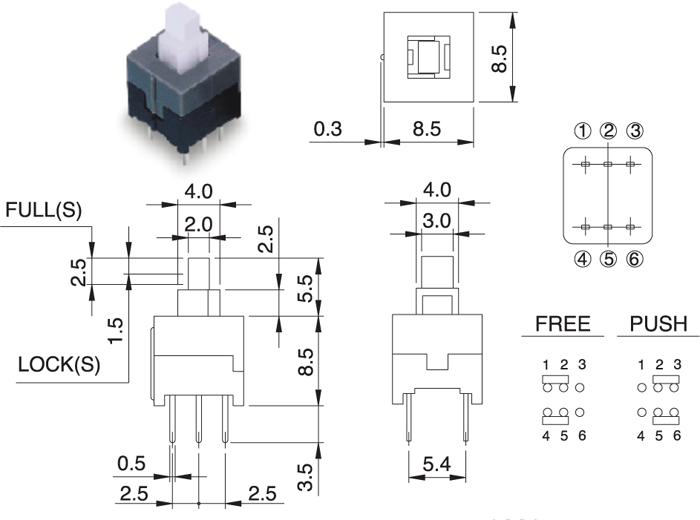

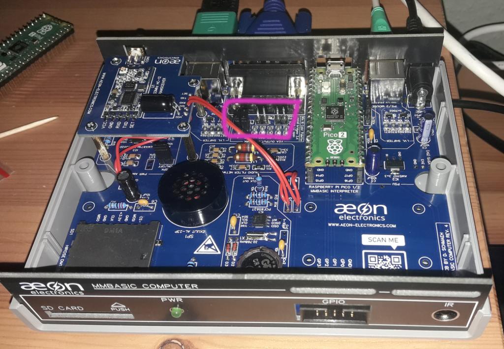

To quickly switch the color palette of the VGA121, a push-button switch can be made on the board instead of jumpers.
Amnesie
Joined: 30/06/2020
Posts: 763
Posted: 03:55pm 30 Jun 2025
Hi javavi,
I also thought about that and have proper switches here, but there is no room left on my pcb to implement it without messing around with too long pcb tracks.In 99% of the time I have it set to the "Windows 16 colour palette" ... only made it switchable for others than me, who use the standard palette.
Greetings

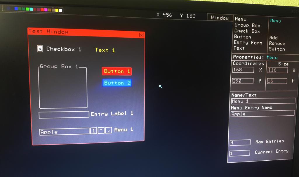

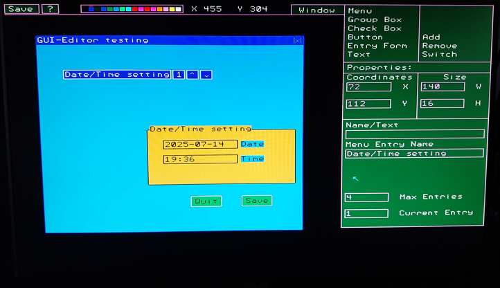

New Update:
Now you can place / move all GUI items via mouse rightclick (and release with leftclick). So just one rightclick on the screen to enable the move action, and then just one leftclick and the item will be placed.
Don't forget to SWITCH to the item you want to move (see video):
Video
I also added new function for specifying the max characters for the entry form.
gui_editor_b22a.zip
Greetings

Posted: 01:02pm 06 Jul 2025
I've tested your program a bit. I've programmed a lot in Visual Basic.NET over the years, and now it's come to PicoMite...
I can only say very good work...    Hope you continue to build on this... I'll be the first to test it...
