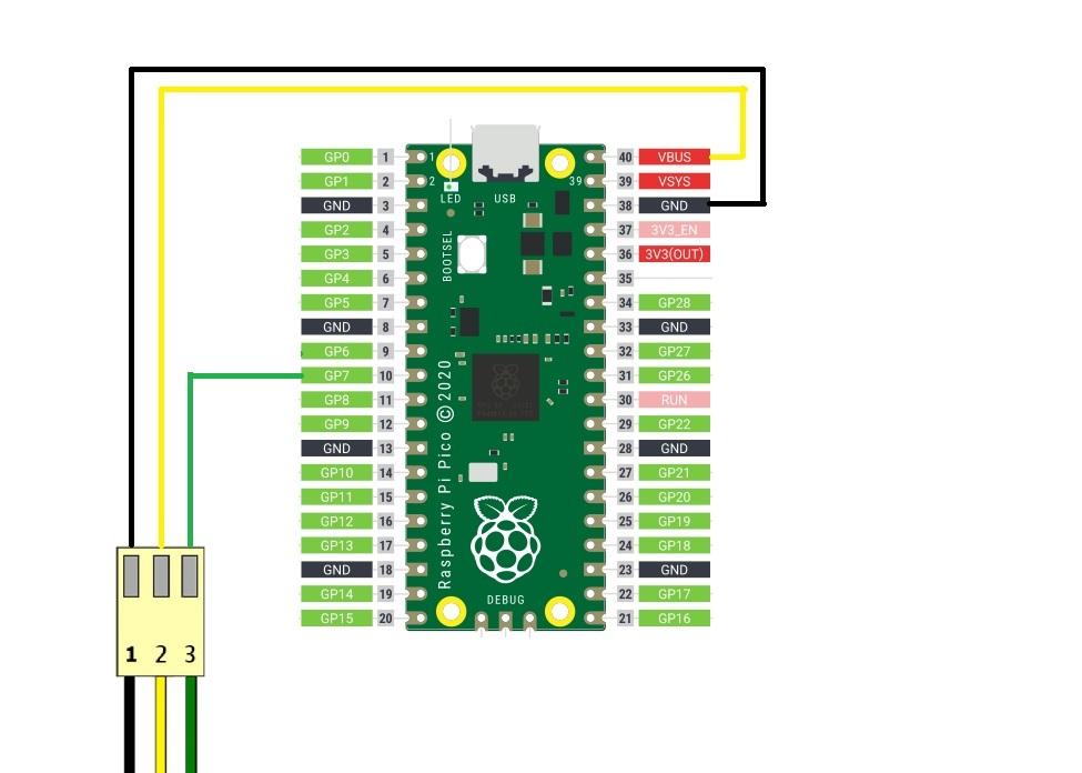

Some time ago I have had a small problem, which is not being able to measure rpm.
I use a CPU fan as a reference to be able to measure, but the readings always come out at 0.
attached the reference image.
I set OPTION COUNT gp6,gp7,gp8,gp9
on SETPIN i try PIN,CIN, and FIN.
and the code i use the same in page 46 of last MMBASIC manual.
In advance, thank you very much for your help.

Try outputting a PWM signal to a pin connected to pin 3 on your connector. If your count then works, that tells you that there's a problem with the wiring to your actual device. If it doesn't work, there's a problem with your code.

Typically, a 3 wire fan has power, ground, and pwm control for fan speed. Fans with a 4 wire connection have a tacho output and pwm.
Are you sure your 3 wire fan has tacho out? Note that a tacho output needs a pullup resistor (10k to 3.3v when used with a pico) to work.

The green wire of the CPU fan gives the signal to measure RPM, the problem is that not work, this wire have more than 3.3V and Ground(when sense).
I used another sensor through an optocoupler, where pin(gp7) has pullup (10k to 3.3V) and the optocoupler connects to ground. This scheme did work.

First check that the Pico is reading frequency correctly, as Lizby suggested.
Put a jumper from GP2 to GP7 then enter the following at the command prompt:-
> setpin gp2, pwm : pwm 1, 1234, 50 : setpin gp7, fin : Pause 2000 : ? pin(gp7)
 1234
If the output is 1234 after 2 seconds then that is working. The pause is needed to allow time for the PWM to start and then to count pulses for 1 second.
Remove the jumper.
To reduce the 5V signal to 3.3V use a voltage divider. 18kΩ from fan output to GP7 and 33kΩ from GP7 to ground.
Then run the fan and try this:-
> setpin gp7,fin : do : ? pin(gp7) : Pause 1000 : loop

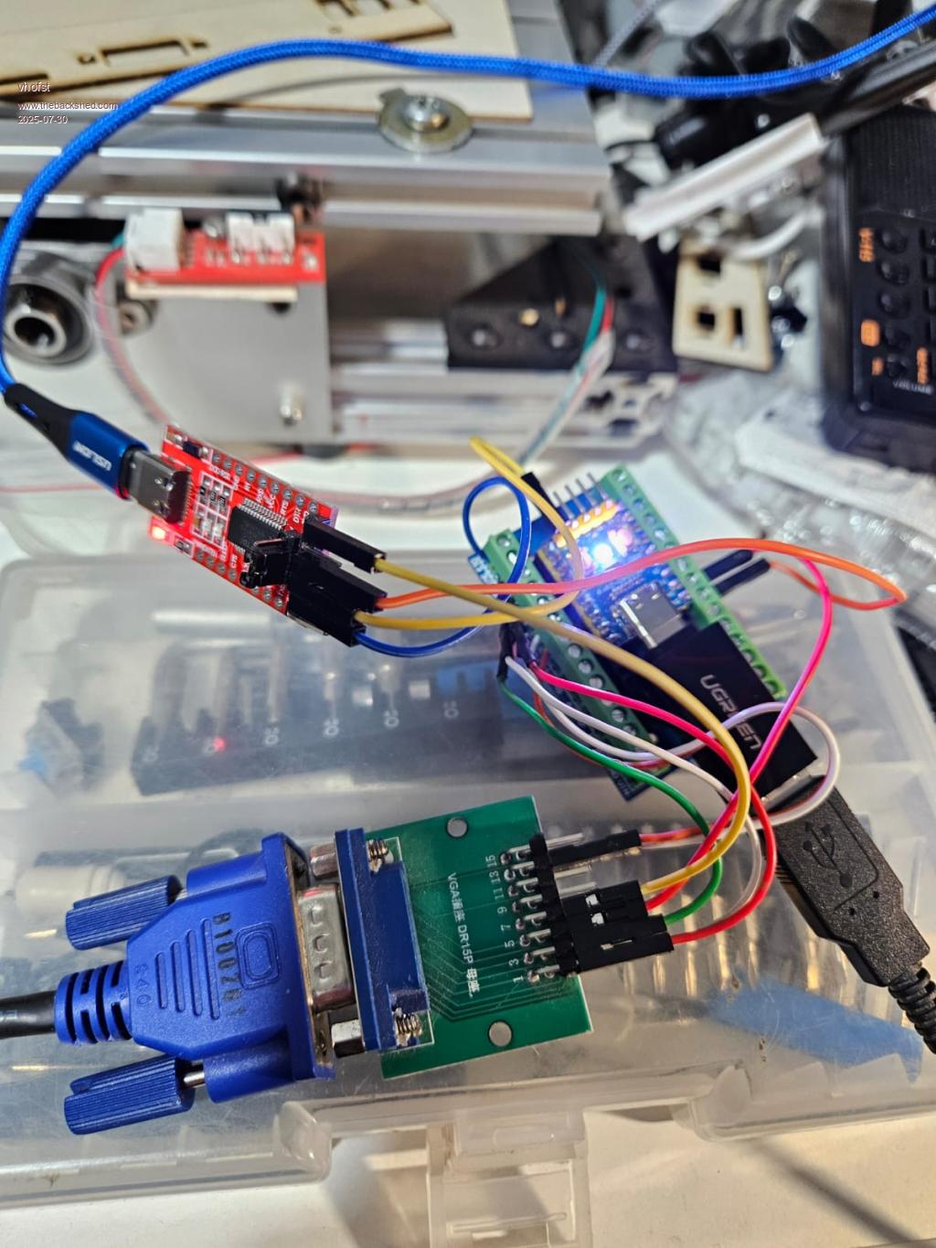

By the way, the RP2040-Zero is a very good format, but it happens to lack all the necessary pins to use PicoMite VGA. Is it possible to reassign them?
My best regards.

  Manual said  OPTION VGA PINS HSYNCpin, BLUEpin
  VGA VERSION ONLY
Changes the pins used for VGA display output allowing more flexibility in PCB design or wiring.
“HSYNCpin” defines the start of a pair of contiguous GP numbered pins that are connected to HSYNC and VSYNC
“BLUEpin” defines the start of four contiguous GP numbered pins that are connected to BLUE, GREEN_LSB, GREEN_MSB, and RED

This only works with the VGA version of the firmware.
And that version uses gp8 and gp9 for ps2 keyboard. Make sure these are not causing conflict.

Correct. Should work. Problem is that the defaults for VGA and PS2 could conflict right after installing the firmware , until the moment they are repositioned.
Noted, VGA starts sending VGA on GP17...21, and that could cause problems when these pins are attached to other chips or sd card. Better not put a sd card in until the pins are correctly configured.
