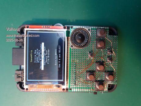

The Game*Mite was developed few years ago by BigMick and thwill. It looks like they took the original Nintendo GameBoy handy form factor as an example.
It consists of a single PCB that holds the PicoMite, LCD, buttons, audio amplifier, and battery charger... and an expansion connector.
Last year, Geoff used the idea and changed the form factor. He used the same LCD, but a different RP2040 board, charger, audio amplifier, but it is compatible with the Game*Mite. Big pro: he designed a housing. Big con: no expansion connector.
And now we have RP2350... and MMBasic 6.00.02...
Are these compatible ??
From earlier experiments I already build a Game*Mite with RP2350 (pico 2 based), besides my original Game*Mite (pico based). But I most lacked a robust housing.
I found a suitable commercial housing, but was very disappointed when I received it. It had features I did not like, was just a tiny bit too small, and had a built in battery bay.
My Motivation
I think the Game*Mite can be so much more than a Game console. There are plenty of similar game consoles for near-nothing commercially available. But here we have the golden opportunity of a development platform for all sorts of applications. I already  demonstrated a thermal camera on Game*Mite, and there is so much more.
But back to business..

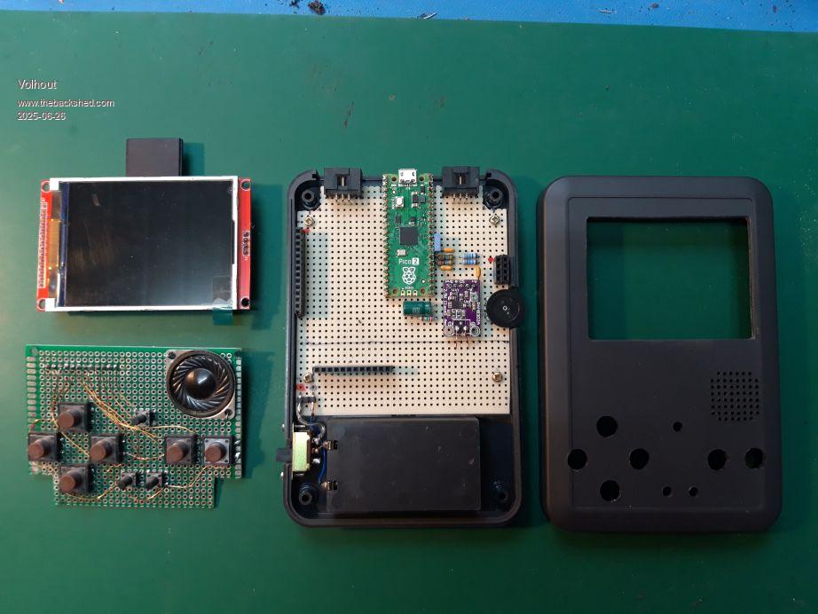

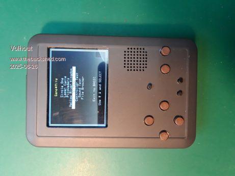

Step 1: Make a Game*Mite fit in the small robust housing. It is not too difficult. The Game*Mite consists of only few components, 3 modules (pico, charger, audio amplifier) and buttons. Just take a piece of experimenters PCB and solder few wires. Many compliments go out to Peter, who made it possible to make the SYSTEM SPI driver so robust that the wiring to SD card, LCD and TOUCH driver can be made with flying wires, no need for matched impedance traces, or good isolation. This deserves respect. Thank you Peter..
This is the result of 1 evening soldering, drilling and sanding.
Under the hood
The building blocks
Next part will explain how to put MMBasic on the Game*Mite, and will provide patched files that make the original Game*Mite software compatible with MMBasic 6.00.02.
P.S. I had to change the 14 pin expansion connector to 2x6 pins because the 14 pin would not fit. In future posts I will design everything around the original 14 pin header, as I still have my original Game*Mite RP2040 untouched.
P.P.S. as design choice I use 2xAA batteries. I do not need the charger circuit in the original Game*Mite, I connected the batteries (switch) via a P-channel FET (AO3401) according the RP pico datasheet to prevent charging of the alkaline cells.

Posts: 9328
Posted: 09:55am 26 Jun 2025
That's very nice indeed! :)
It'll be interesting to find out the battery life on two AAs. The Pico will keep running but I suspect the backlight might start to get into problems first. Unless you powered it from the 3V3 output from the Pico?

Posts: 6253
Posted: 10:45am 26 Jun 2025
Hi Mick,
The backlight is powered from 3V3 (see Game*Mite schematics).
Hi LouisG,
I did change the resistors on one LCD display from 1k to 100 ohm. On the display in this build I did not change the resistors (they are 1k). Both work with the SD cards I use.
Arne

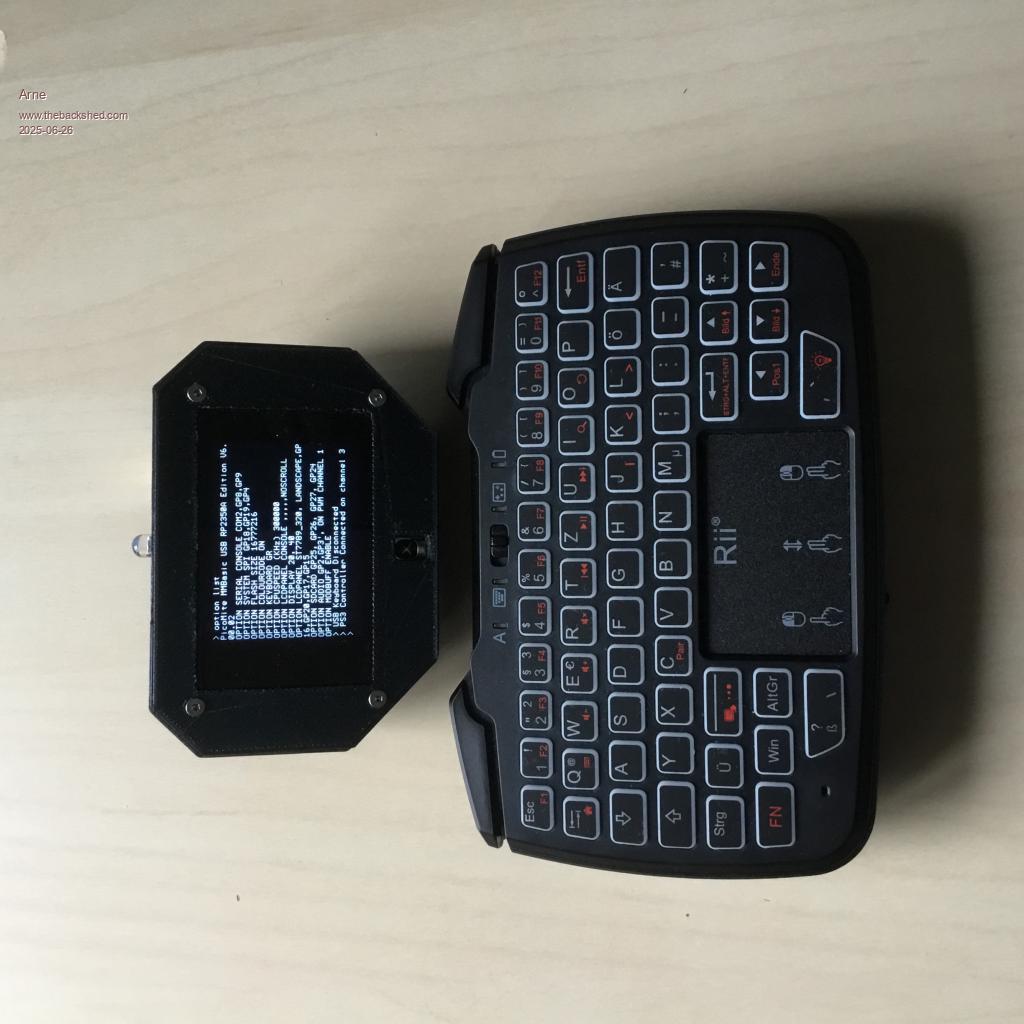

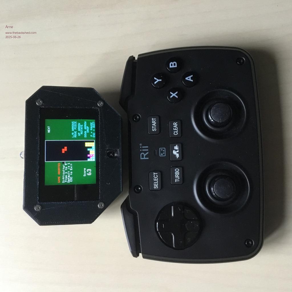

I had the Idea to build up a Picomite „Portable“.
Basically I used the Waveshare RP2350 2 inch Capacitive Touch Display Development Board, 240×320.
Due my printer does not produce good  quality it looks not very nice.
Mainly you have all relevant features you need on the board
The biggest disadvantages are that:
- sd-card slot is in the middle of the board
- the charging circuit of the board is not providing 5V to the USB-port for e.g. a keyboard.
For this a step up converter must be implemented.
Next I will try the 2.8 inch variant because it has additional  audio hardware, RTC and some other features.
Arne
Posts: 6253

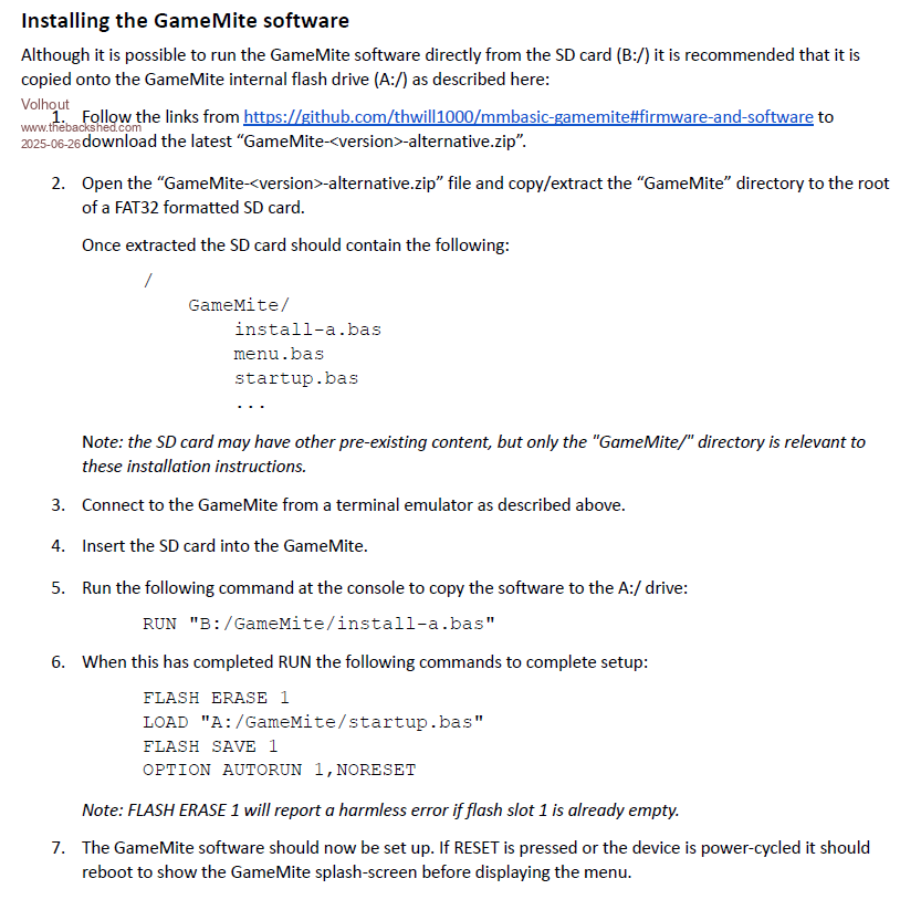

PART #2
Loading the software.
First I would like to point everyone to the high quality archive Tom (thwill) made for the Game*Mite.
Game*Mite archive
At moment of writing, the archive is still based on 5.08.00. We are going to update to 6.00.02. The new 6.00.02 PicoMite firmware (MMBasic) is attached here
MMBasic60002.zip
Unzip the file. Use the standard method load uf2 files on the RP pico
- first Nuke the pico (or pico2) using flash_nuke.uf2. Wait for the reboot. Note : flash_nuke works on both 2040 and 2350.
- on the pico program PicoMiteRP2040V6.00.02.uf2
- on the pico2 program PicoMiteRP2350V6.00.02.uf2
Then initialize the platform with:
OPTION RESET GameMite
For installing the software I used Tom's guide in the Game*Mite user manual. The patched software is attached here.
GameMite_1.3_60002_alternative.zip
use this procedure (you need an SD card to do this).
After reboot you should have a working Game*Mite with 6.00.02 PicoMite firmware.
Let me know if any of you run into trouble, and I'll try to help out.

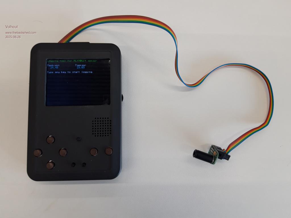

About motivation,
This is the type of application I envision for the Game*Mite when not playing games..
A logging IR temperature (this is a single pixel narrow angle camera). It is a PicoMite VGA application directly running on a Game*Mite. It needs a bit of tuning (larger font, assign a button for logging).

Hi Harm,
I'm getting some very strange things happening, I've installed 6.02.
PicoMite MMBasic RP2040 Edition V6.00.02
OPTION SYSTEM SPI GP6,GP3,GP4
OPTION AUTORUN  1,NORESET
OPTION COLOURCODE ON
OPTION CPUSPEED (KHz) 252000
OPTION LCDPANEL ILI9341, RLANDSCAPE,GP2,GP1,GP0
OPTION TOUCH GP5,GP7
GUI CALIBRATE 0, 407, 267, 897, 677
OPTION SDCARD GP22
OPTION AUDIO GP20,GP21', ON PWM CHANNEL 2
OPTION MODBUFF ENABLE  192
OPTION PLATFORM Game*Mite
I've used your updated MMBasic60002.zip, putting all contents onto a SD.
I've followed steps 5 and 6 from the install instructions.
> a:
> files
A:/
  <DIR>  .
  <DIR>  ..
  <DIR>  GameMite
00:00 01-01-2024          4  bootcount
3 directories, 1 file, 57344 bytes free
> chdir "GameMite"
> files
A:/GameMite
  <DIR>  .
  <DIR>  ..
00:01 01-01-2024      19013  3d-maze.bas
00:01 01-01-2024       2440  ChangeLog.txt
00:01 01-01-2024      14464  circle.bas
00:01 01-01-2024      60000  circle.mod
00:01 01-01-2024      35328  ctrl-demo-2.bas
00:01 01-01-2024      40320  fm.bas
00:01 01-01-2024      54887  kingdom.bas
00:01 01-01-2024      52608  lazer-cycle.bas
00:01 01-01-2024       1082  LICENSE.txt
00:01 01-01-2024      32969  menu.bas
00:01 01-01-2024      27776  pico-vaders.bas
00:01 01-01-2024      48591  sound-demo.bas
00:01 01-01-2024       8310  splash.bmp
00:01 01-01-2024       4736  startup.bas
2 directories, 14 files, 57344 bytes free
> flash list
Slot 1 in use: "  ' Transpiled on 07-01-2024 18:06:11"
Slot 2 available
Slot 3 available
however when I run, by powering off or resetting, I get.
[92] Load Image gamemite.file$(sys.get_config$("splash", "unknown", CONFIG$)), 32, y%
Error : Could not find the file
I am currently trying to debug, but if you have any ideas?
Regards, Kevin.
PS. If I issue the command.
load image "A:/GameMite/splash
the Spash image loads fine?
Edited 2025-06-27 01:12 by Bleep
Bleep
Joined: 09/01/2022
Posts: 875
Posted: 03:26pm 26 Jun 2025
Ok,
If I comment out line 92 and hard code the load image, the image loads, but then I get an error due to the version being wrong
 Const MIN_FIRMWARE = Val(sys.get_config$("firmware", "9999999", CONFIG$))
Which is probably fair enough, If I correct that, I'm getting another File not found from lower down in the code?
Regards Kevin.
Posts: 4410
Posted: 03:39pm 26 Jun 2025
I'm gratified to see you carrying the torch @Volhout ...
... however it looks like "GameMite_1.3_60002_alternative.zip" is missing the file "GameMite/.startup"
Sorry for not "coming out to play", real-life is getting in the way.
Edited 2025-06-27 01:47 by thwill
Bleep
Joined: 09/01/2022
Posts: 875
Posted: 03:50pm 26 Jun 2025
Hi Tom,
Yes that is it, I've also copied over .gm-menu as well, to be sure and it is now working fine :-) Thanks Tom & Harm.
Regards Kevin.

Posts: 6253
Posted: 06:50pm 26 Jun 2025
  thwill said  I'm gratified to see you carrying the torch @Volhout ...
First of all, My 2 units start up normally. And I nuked flash before I followed the install. But indeed I see no .startup file.
This will take some time, but I will come up with a solution.
Edited 2025-06-27 04:53 by Volhout
Posts: 4410
Posted: 06:56pm 26 Jun 2025
Files whose names have the .prefix are hidden on Linux, see them with 'ls -a'.
All of this stuff was built on Linux originally.
Posts: 6253
Posted: 07:18pm 26 Jun 2025
Hi Tom, others....
I am very sorry about this, but here is the alternative package including the .startup file. Kevin, thanks for testing. Tom, thanks for the advise (it would have taken me significant time to find this myself).
In fact: I nuked the 2350 unit, and it had the .startup file (it was in my original package). Then I fixed another bug, recreated the package, and lost the .startup file.
GameMite_1.31_60002_alternative.zip
@Tom, I modified .startup to reflect 1.3 version of the package.
P.S. Kevin, thanks to you I re-read the section on the .gm-menu.... this is great..
Tom, thanks for this jewel.
Edited 2025-06-27 06:29 by Volhout
