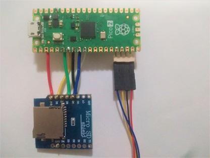

This may be a useful config. It is very quick and easy to get up and running.
It is surprisingly reliable + robust if you use solid wire   The SD card
adapter has a bypass capacitor included.
(Don't know if it will run MMBasic or not.)
The 4pin header allows a off-the-shelf stemmaQT/qwiic cable to be used.
Pico   Wire    SD adapter
GP4    GREEN   D6 MISO
GP5    YELLOW  D8 SS
GP6    BLUE    D5 CLK
GP7    WHITE   D7 MOSI
GND    BLACK   GND
3v3    RED     3v3
                     I2C
GP12   (blue)         SDA
GP13   (yellow)       SCL
GND    (black)        GND
3v3    (red)          3v3
(note - do not connect GP14 to the 4pin plug)

It runs programs I have written for it, using the USB/serial for user i/o,
but I was mainly thinking that MMBasic for Picomite would also run on it.
I thought MMBasic could be optioned to use the USB/serial i/o and the sdcard and i2c connections (?) as they are pretty routine.
Now I think of it the recent Pico2 computer used a separate usb/serial chip so
I am wondering if it can still use the inbuilt pico2 socket for serial comms.

eg maybe using
OPTION SDCARD CSpin, CLKpin, MOSIpin, MISOpin
as in OPTION SDCARD  GP5, GP6, GP7, GP4

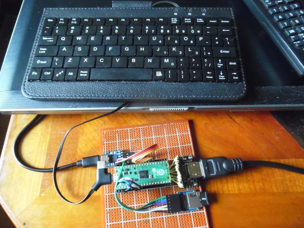

I just made a simple usb hdmi board. I changed the options from standard so the usb to ttl uart is one side of pico and sd card other side.
option list
PicoMiteHDMI MMBasic USB RP2350A Edition V6.00.02
OPTION SERIAL CONSOLE COM2,GP20,GP21
OPTION FLASH SIZE 4194304
OPTION COLOURCODE ON
OPTION KEYBOARD UK, 0, 0, 600, 150
OPTION RESOLUTION 640x480 @ 252000KHz
OPTION DISPLAY 30, 53
OPTION SDCARD GP2, GP6, GP7, GP4
