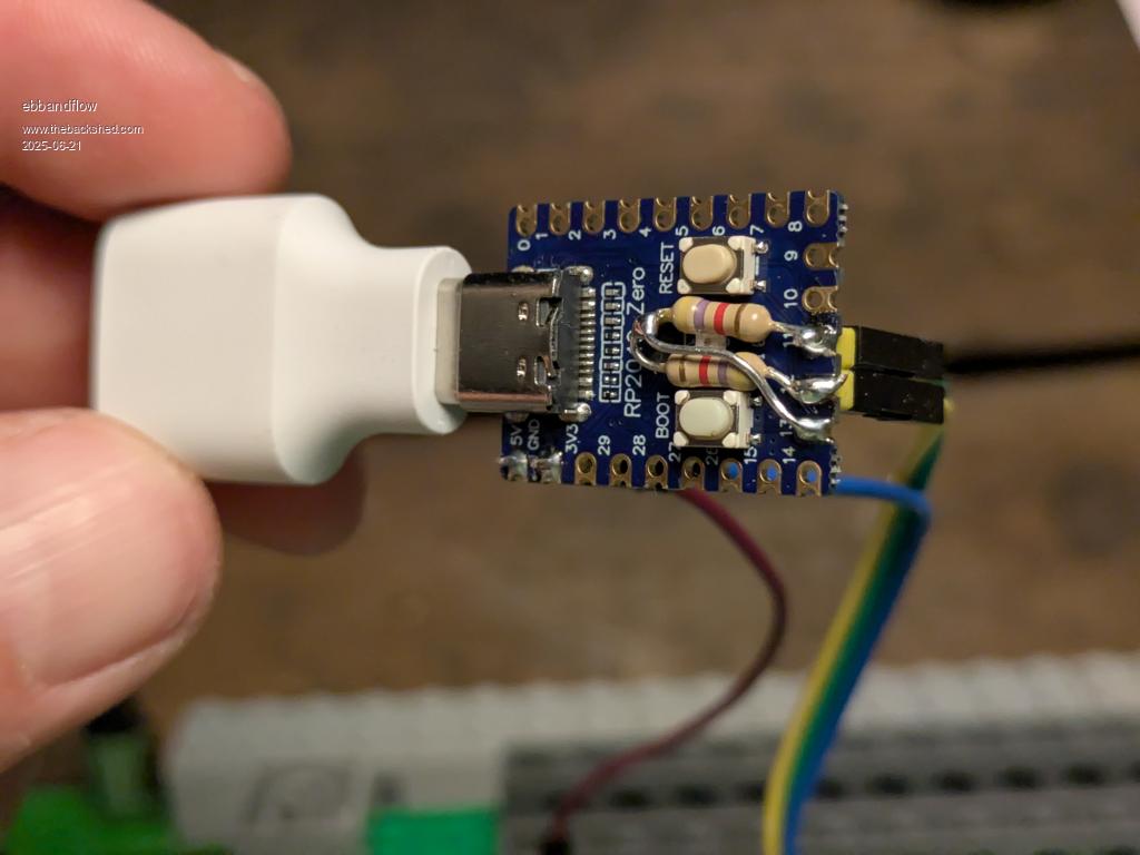

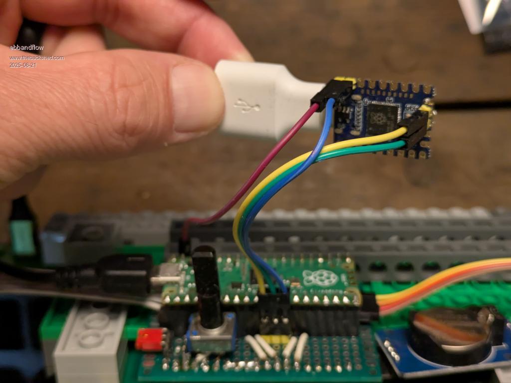

Hi Daniel, I struggled with the same issue and ended up having luck with ps2x2pico and an american keyboard layout and posted about in the last post here
"RE: my input speed issues, I ended up making a USB -> PS2 converter from an extra RP2040 Zero flashed with the ps2x2pico firmware. I skipped the level converter shown in the github and instead added a 4.7k pullup resistor from GP 13 to GP11 (PS2 Data) and GP 13 to GP12 (PS2 Clock), and then connecting those to the picomite and linking VBUS between the two picos as well as GND. Now I can use a USB keyboard with the input speed of a PS2."

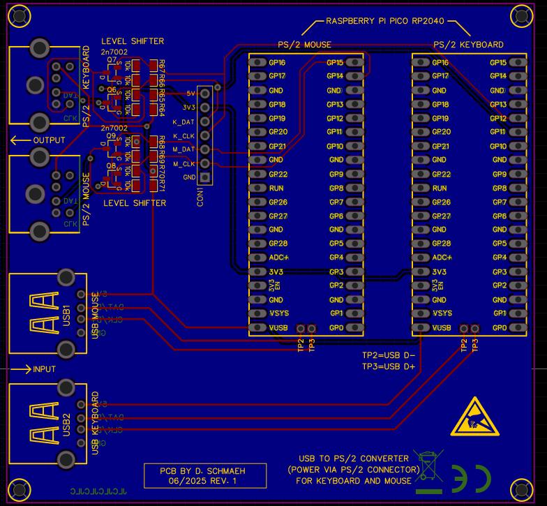

I decided to do a seperate PCB. I don't like the USB-HUB idea for three reasons:
1. there were already problems with counterfeit ICs
2. USB dongle-li-di blah blah (too much connector cables)
3. I am in the need for a specialized HUB ICs and have no clue about its availability / obsolesence plan
So let's just take two Picos. Why? Prices for a Pico are a joke, especially the needed RP2040. And even if you go the HUB-IC route; this is an IC, too. Ok you can get those ICs for 1 dollar / euro.. But if I socket my Picos I can do way more with them, since they are not specialized and can be re-programmed.
Another benefit is, that there is no cable salat anymore   There is only one downside (if one cares) and that is space. For me this isn't a problem.
For me this approach is far superior to the PicoMite USB variants. If one types fast, there is no option around it, I think - unless Peter could speed up things. But I guess there are limits. I have no clue about this...
A HUGE benefit is also, that there is no need for a USB variant anymore, you can even  use USB and PS/2 "at the same time" - I mean without re-flashing the firmware - how cool is that?!
If there is interest I will publish the gerbers, for now I have to get them made for me, if they arrive I will report back if everything works fine.
"CON1" on my PCB is only for measurements / optional...
Greetings

If using the ps2x2pico firmware, wouldn't you want to control (the HV side of) the level shifters with gp13's as shown in the github 'schematic'? Otherwise you'll face the same problem you had when not using pullups to gp13. I like the idea of putting this in a tidy little converter board, it's a good plan.
Edit:
Also, for greater compatibility w/ existing picomites in the wild, what about adding some jumpers and locations to populate pullups to bypass the level shifting and allow for the circumstance of only needing to directly connect to another Picomite that does not expect 5v level signals?
Edited 2025-06-22 04:24 by ebbandflow

  ebbandflow said  If using the ps2x2pico firmware, wouldn't you want to control the level shifters with gp13's as shown in the github 'schematic'? Otherwise you'll face the same problem you had when not using pullups to gp13. I like the idea of putting this in a tidy little converter board, it's a good plan.
Good that you ask, because I forgot to mention this! Your 4k7 pullups are not needed here because there is already a level shifter (to the upper left on the PCB).
I don't use GP13 in both cases, because GP13 is only a "DOUT" set to HIGH, that means this pin only delivers 3,3 volts. If you look carefully on the PCB (I know the resolution is bad) you can see that I am using the 3v3 Pin on the Pico itself going to my level shifter. So I am doing the same here, only direcly via the 3v3 pin from the pico through the level shifter.
I am almost certain why "NoOne" (the designer of this cool firmware) chose GP13 for this, instead of the original 3v3 pin on the pico. That's just because he used a ready made level shifter you can buy online everywhere - which dictaded the pinout. And to match the pinout of the level shifter he utilized GP13 for this.
Long story short: not needed, I doing it already.
Greetings

Posts: 6253
Posted: 06:38pm 21 Jun 2025
Daniel,
The original VGA design 2 has 2 spare pico footprints. In socket 1 the VGA pico, socket 2 tje no-one, socket 3 to jumper the PS2 signals between 1 and 2. For almost no money you JLC the gerbers for 5 boards. G738 housing.
For VGA design 1 silicon chip magazine already published a usb 2 ps2 piggy back board.
