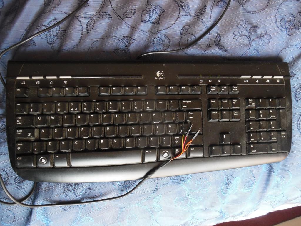

stanleyella
Joined: 25/06/2022
Posts: 2807
Posted: 03:48pm 17 Jun 2025
When I first used mmbasic the manual said you can use a 3.3V ps2 keyboard no logic level converters. I found a black one and cut the plug off and stuck pins on the lead and it worked. 3.3V ps2 keyboards must be rare cos it was usb after.
