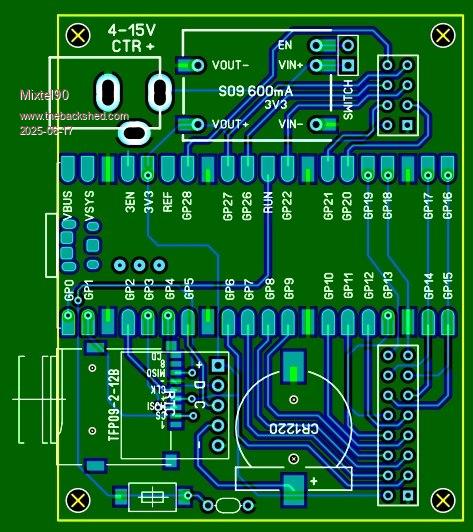

That looks very nice ! [ Give me a chance to work through the detail yet ]
so far- I'd put 1uF and 100nf capacitors on the SD socket power line to catch blips
ed- and a I2C socket (Stemma / Qwiic) somewhere
Edited 2025-06-17 11:34 by zeitfest
Posts: 6253
Posted: 06:18am 17 Jun 2025
Hi Mick,
- widen the 3.3V trace. The S09 is 600mA capable, one may use it...
- the RUN switch, put a 10n cap to ground to avoid noisy resets.

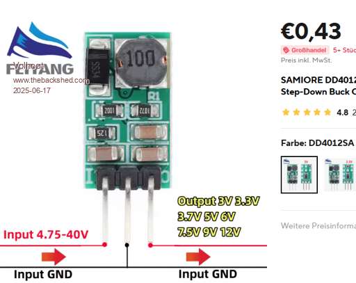

I support your design choice for the S09 buck-boost regulator, but personally I would have gone for a buck regulator, with wider input range, maybe even a 5V one, and supply 5V at one of the pin headers. Too often I find this 5V useful. (like with the DAC output (thread about R-2r ladder DAC) for Nimue to test LED's)

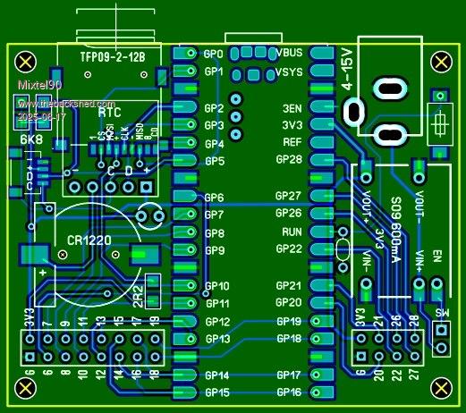

Posted: 08:07am 17 Jun 2025
Just playing again this morning...
Quite a bit of tidying up and rearranging.
Note that the USB socket can't power the Pico as the switcher is disabled. You will need to power via the barrel jack while programming so there will be two leads involved. :) Also, you can't power stuff via that connector, so it won't be suitable for USB Host mode.
I picked the S09 because a) it's stupidly cheap and easily available and b) I already have a macro for it because I have some. :) It also sits flat on the board, which may be useful. That looks like a nice one though. :)
I've reverse-engineered the S09. In theory (untested) you can change the feedback resistor for a 250K pot + 82K series resistor and get 3-10.5V variable out of it. :) I just don't have a 250K LIN pot to hand.
