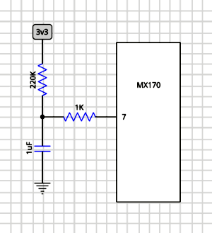

How about a RC network. A resistor trickle charges a cap. At the trigger point the MX170 wakes up, increments a counter, pulls the pin low to discharge the cap through a diode, makes it an input again then goes back to sleep. It may not be too accurate, depending on the type of capacitor used, and may also drift with temperature. That would at least give you a sort of clock without having to use a 555 as well.

not a bad idea     i've got plenty of spare pins, so could use one to monitor the voltage on the capacitor and another to connect a low value pulldown resistor for discharging once 300ms is reached. +/-20% variance in duration isn't an issue; if i use an analog input i can even get some granularity and do a self-calibration at startup.

Posted: 01:08pm 15 Jun 2025
success, using an external RC as suggested by Mixtel90, using just a single pin:
and the following code:

this is the output from the above code:
> RUN
calibration = 2.404 volts
302     302     302     303     302     302     302     302     302     302
303     302     302     302     302     302     302     302     302     302
302     303     302     302     302     302     303     302     302     302
302     302     302
i've also been able to verify that CPU SLEEP does not have any effect on the timing.
rob   :-)
