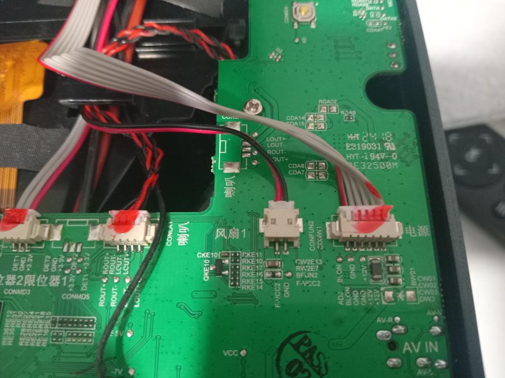

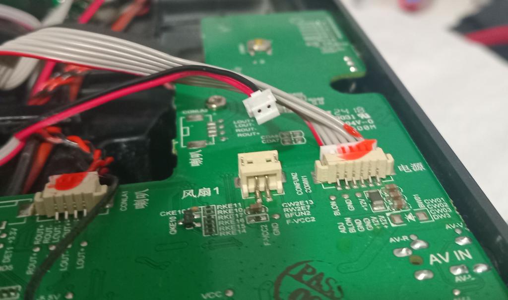

Hi all.

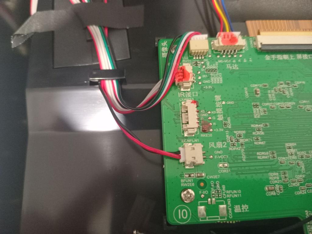

I am trying to ID a connector from inside an LCD projector.
Both of these connectors are the same, and both of them connect to 12v cooling fans.
Can anyone help me ID what they are, so I can order some replacements?

JST XH ?
Posts: 9328
Posted: 08:57am 14 Jun 2025
They definitely look like JST of some sort. There are variations in pin pitch, make sure you get the right one.

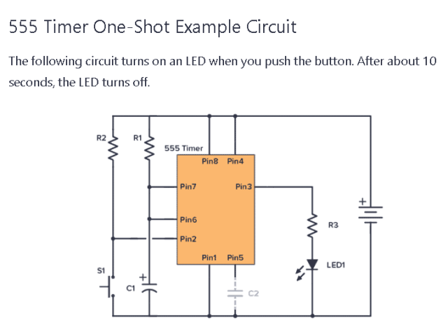

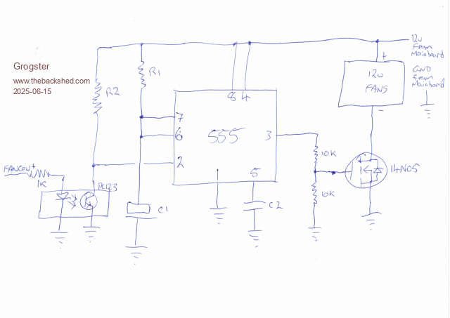

Current idea - 555 "One-Shot" circuit:
Replace LED1 with an N-Ch MOSFET as a low-side switch, fans in parallel in the high-side to 12v.  S1 replaced with PC123 NPN opto.  When the projector is turned on, the opto will trigger the 555, and hold the 555 in the "Ready" state - the fans will spin-up.  When you turn the projector OFF, the opto will drop out, and the 555 will start running at that point, keeping the fans running.  When the time is up, the 555 will switch off, turning off the fans.
Does anyone see any thing obviously wrong with that idea?
I will probably still breadboard it to check this will work, but then I will get some simple PCB's made.

Posts: 3429
Posted: 05:00am 15 Jun 2025
A CMOS 555 will save 10mA when idle, if you are after minimum standby power.

Now, this is my free-hand drawing of the schematic I am planning to breadboard in the next few days.  If anyone sees anything obviously wrong here, please do post a comment.
I have a whole bag of 14N05 N-Ch MOSFET's, so that is why I am using these to drive the fans.  The maximum gate-source voltage is +/- 10v though, so with a 12v mainboard voltage, I am using the two 10k's to make sure the gate of the 14N05 never sees more then 6v worse-case, which is still well within the 10v maximum.

It's a good idea to have a pull-down on the gate anyway. It never does any harm. :)
If your signal from the fan socket is correct, i.e. the fans are switched to +12V and share a common ground, then you could replace the opto with a NPN transistor and base resistor - or a small mosfet like a 2N7000. R2 can probably be 10K or so.
Just a thought... Have you checked to see which side of the fans is switched? You might be able to simply link the switched side to the appropriate supply rail to force them on. No need to rewire them to another board at all. Of course, doing that might power up the rest of the device. :)

NPN vs Opto - good point.
Fans to supply rail - yes, that probably WOULD work, but the problem is that the fans would then run 24/7 - even if the projector was "Off".  That is no good, as it is a projector in my bedroom, and I could not stand the fan noise all night long.

No, what I meant was to switch the fans to the supply rail using a mosfet or even a relay. It won't work if the fans are on a supply shared with the rest of the board though, I suppose, but it might if they are currently switched by something on the board. :)
Posts: 10104
Posted: 07:40am 15 Jun 2025
OK, so I will then proceed along the lines of the 555 circuit, and perhaps just drop the opto, and have an NPN on the input.  Would you be happy with that arrangement?
