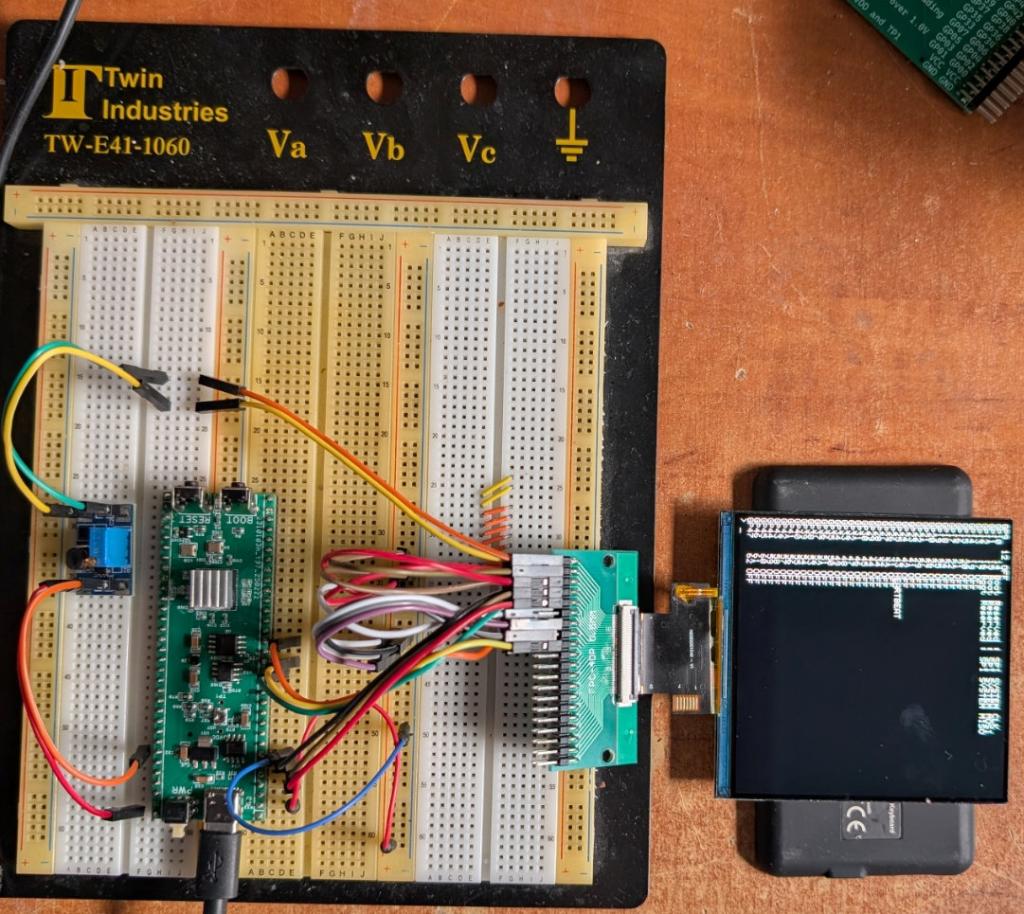

Posted: 12:16pm 08 Jun 2025
This display is available from buydisplay.com
It is a bright 4" IPS 320x320 display with 80 degree viewing angles. It uses the ST7796S controller and I will include support for this display in the 6.00.02 release
OPTION LCDPANEL ST7796SP, orientation, CDpin, RESETpin, CSpin,,INVERT.
As shown the display is in portrait mode which benefits from H/W scrolling.
Connection is a bit trickier than the standard "packaged" displays as it needs a FFC breakout (40-pin, 0.5mm pitch) and a boost converter to generate 15V for the backlight but it is ideal for building into any sort of device.
Wiring is:
pins 1,3,6,12,18: GND
pin 2: +15V
pins 4,5,13,14,15: 3V3
pin 10: SPI-CLK
pin 17: SPI-MOSI
pin 16: SPI-MISO
pin 9: CD
pin 7: RESET
pin 8: CS

For many applications well suited but not for editing text as with every 320 display.
IPS is nice.
I think this is a start of new generation displays. Seen this?

  Quote  For many applications well suited but not for editing text as with every 320 display.
Editing is now pretty OK with continuation lines. The display is as wide as a typical phone and bright and clear. Font 7 gives 53 characters across the screen.

G'day,
That is a nice looking diaplay, and the specs suggest it would be close to daylight readable
Would you be able to read font 7 in the editor with less than perfect (think 50 year old / needs reading glasses / has done a fair amount of welding over the years) eyesight, whilst editing a program?
Might have to get one to try out.

  Quote  Would you be able to read font 7 in the editor with less than perfect (think 50 year old / needs reading glasses / has done a fair amount of welding over the years) eyesight, whilst editing a program?
My 71 year old / needs reading glasses / has done a fair amount of welding over the years) eyesight, work fine with this display while editing a program

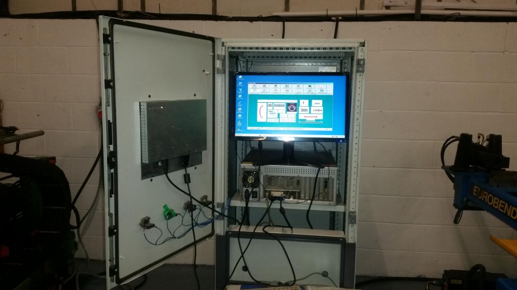

Posted: 07:45pm 08 Jun 2025
This what I get:
"Industrial Control by Beckhoff"
Except the HMI is dead and now needs a PC monitor and keyboard. This is everywhere and the "yes men":
"Oh but it's worth the £5,000 because it's industrial"
Total BS.
Machines need to be making parts. Downtime is not an option.
