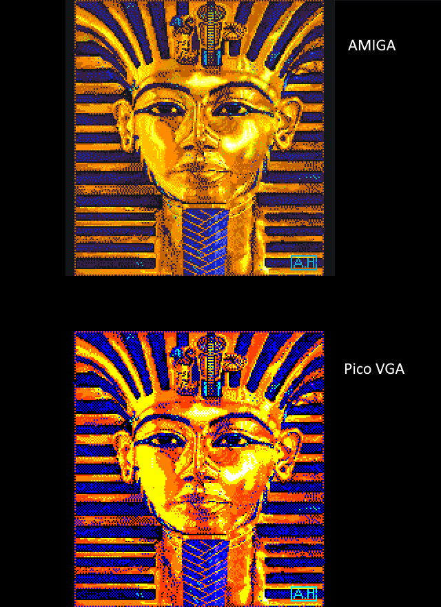

Posts: 3429
Posted: 12:58pm 07 Jun 2025
You can get grey with a RGBI network, though for maximum compatibility with Pico VGA RGIB is better. RGIB resistors
For image conversion I used a Pico LCD and a program (in the link above) to distort the colours so they would decode correctly through the RGB121 codec in the Pico VGA.

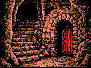

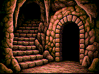

Martin H.
Joined: 04/06/2022
Posts: 1579
Posted: 09:20am 08 Jun 2025
  Mixtel90 said  I can't see anything wrong in that. In fact, the walls and floor were surfaces that could be coloured. The door archways were polygons that were drawn over them, with the doors as further polygons inside them, covering the black area.
so from this
to this
Edited 2025-06-08 19:26 by Martin H.
'no comment

Posted: 09:30am 08 Jun 2025
The door could be on framebuffer L
Martin: that is not PicomitVga color palette.
Tom, if you like the 16 color Windows 95 palette more, we can standardize on that. Even when so late in the game, I am sure we can create a conversion for It. Modifying the hardware is simple. It can even be made switchable. Daniel did that.
P.S. I like what you are doing. That was also on my long list of things to do. When I talked about Magnetic Scroll adventures.
Edited 2025-06-08 19:42 by Volhout
Martin H.
Joined: 04/06/2022
Posts: 1579
Posted: 09:50am 08 Jun 2025
sure it is
'no comment
Posts: 9328
Posted: 10:10am 08 Jun 2025
Nice dithering. :)
I like the black doorway effect. It makes it more mysterious. :)
Posts: 4410
Posted: 10:39am 08 Jun 2025
  Mixtel90 said  Nice dithering. :)
Yes, Martin should do all the graphics for me .
