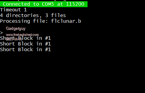

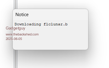

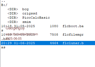

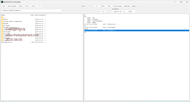

Not sure how to attach screenshots to show that in the Maximite File Commander in the folder view it seems that the folder view picks up only 40 characters in a row (exactly like on the Picocalc screen) - as a result the file name is in two lines. The first line (40 chars) is "filename.b" and the following line has "as"
Then, when I click on copy (using the <<< button) it picks up only the text from the first line "filename.b" - which then of course does not work.
So - how can I see more than 40 characters on the File Commander Screen, or how can I tell to File Commander  to take the full file name (which is actually in two lines in my case)

There is an OPTION to configure your console to a greater number of characters.
This is a picomite command (not MMCC)
I am not sure of the syntax required but that will allow long file names to be displayed.
Posts: 3429
Posted: 06:58am 05 Jun 2025
Jim may have a better idea but one way may be to increase the line length, the catch is it requires disabling console output to the LCD panel.
OPTION LCDPANEL NOCONSOLE
then
OPTION DISPLAY 55, 155
for 55 lines, 155 characters - choose what suits your PC window
You can restore the LCD console later.
OPTION LCDPANEL CONSOLE

Posted: 07:46am 05 Jun 2025
Thank you all. This works now!
Option lcdpanel noconsole did
the trick, followed by
option display 50,155
Thank you so much
