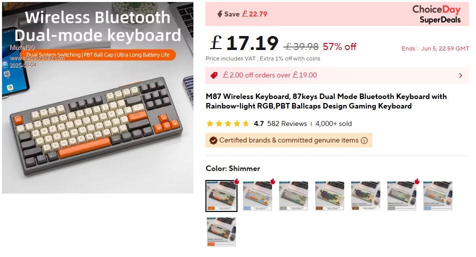

This one is the M87 "Dual Mode Wireless keyboard"
I'm assuming you mean a "standard USB keyboard" of the wired USB type, not this one. However, I don't regard any keyboard with built-in trackpads, USB hubs, programmable keys, scroll wheels or knobs as "standard". :)  None of those are required to produce "standard" USB signals for any of the devices and MMBasic won't recognise the add-ons. Additionally, some RGB keyboards won't work because the RGB section is programmable again. Some N-Key rollover keyboards don't work as they require multiple USB channels (which is why the best gaming keyboards were all PS2 for a long time - they are faster, with a lot less USB lag).
Having said all that, conventional wired USB keyboards and wireless types using a USB dongle generally work fine, no matter what the make or number of keys.

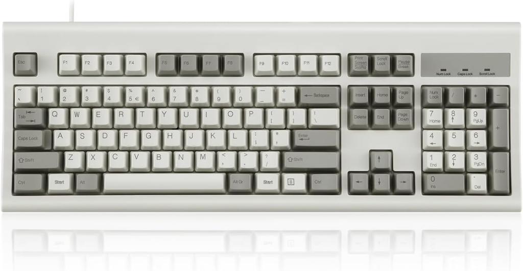

I love this keyboard for my CMM2. But it's full size, and you did ask for compact (photo below).
https://www.amazon.ca/dp/B08F3WBFP1?ref_=ppx_hzsearch_conn_dt_b_fed_asin_title_6&th=1
