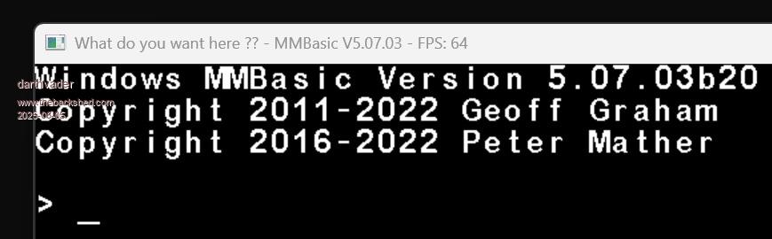

Is there a way to make this go away?

I just want full screen without the banner.

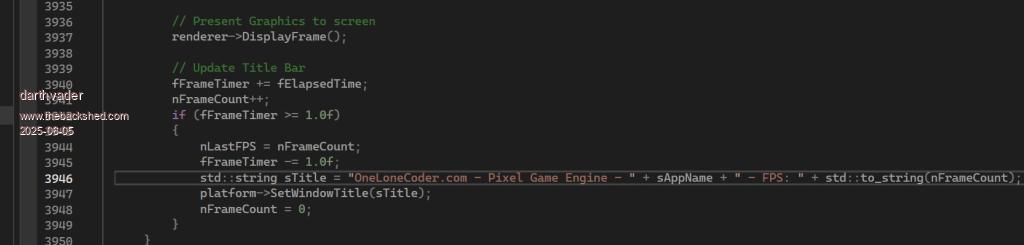

  PhenixRising said  Is there a way to make this go away?
It was easy
You have to change one line in "olcPixelGameEngine.h" from the source ...
Change the text in line 3946 , compile and it's done
Cheers ...

darthvader
Joined: 31/01/2020
Posts: 101
Posted: 04:33pm 04 Jun 2025
It depend what is scary for you
Install visual studio community 2022.
Get the source from Peter Github.
DBL click on the "MMBasic.sln" file , it will open Visual studio
Now chose "Release" and "X86" and go to Generate menu and click "Generate Solution"
After compiling , you get a Release folder with MMBasic.exe in it ...
Not that scary , what you think ?
Or tell me what text you want i can do it for you

I was just want 100% screen for my use, no bar across the top.
