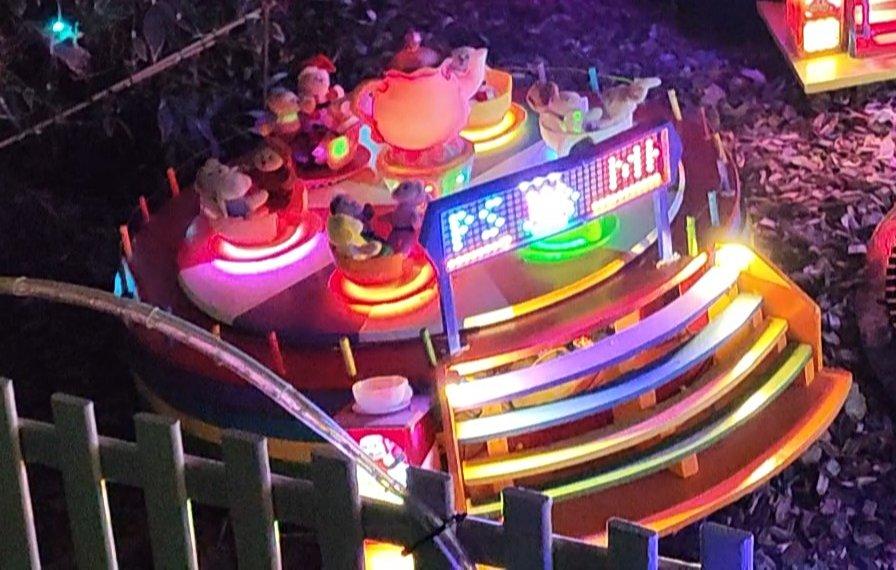

This is a scrolling message using 4 8 x 8 WS2812B RGB displays
The full message is loaded into an array then transferred to the display, then the array ins indexed 8 bytes then displayed again.
The brightness of the LED is determined by the number in the array - 0 - Hex FF
I find that Hex30 is bright enough for most applications. By combining differed values in the RED, Green Blue sections you can generate any colour you require - &h301000  = orange.
hope this may be some help.

Bill.b
Joined: 25/06/2011
Posts: 249
Posted: 07:24am 28 May 2025
Hi Volhout
This program was used for the cupride last Christmas
