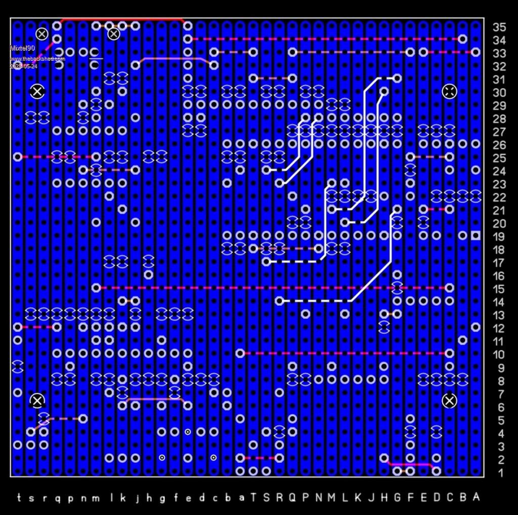

Just my take on a design. This one fits the RM2015S case from Hammond, so it can look rather nice (and even dust-free!). This case can be found for about £3.79 + postage here in the UK (Rapid Electronics). so it's probably hardly worth 3D printing one.
This hasn't been easy to test on SL6, but it does seem to work ok if I swap the strips for normal traces and put the links on proper trace layers.
Note, this uses the Adafruit module for the HDMI connector as there's no other realistic alternative. If you intend to build this get that first. It also uses the "inverted" micro SD card module as that fits the track layout better than most. You may be able to find this without the pins ready soldered, in which case fit them from the socket side.
info.pdf

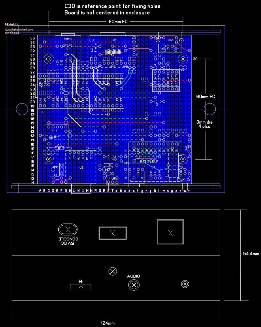

Have you got a solution, how to cut the traces best?
And the cuts are hard to see in the drawing, could you mark them e.g. in red?

You could probably use a piece of stripboard with the resistors mounted on it to connect a HDMI cable. It might be a bit messy but it should work. TBH, even if the Adafruit module is a bit on the expensive side I'd use it. After all, everything else is pretty cheap!
Colouring in SL6 is fun. You have colours for the outline, copper and silkscreen layers. Then there are two internal copper layers. If you attempt to use those as non-conducting layers things all fall to pieces!
Working with stripboard
For cutting traces I've used two methods. A normal drill bit (which works but hurts your fingers after a while) or a proper "spot face cutter" tool. I strongly recommend getting one of those. They are well worth it and last for years. The little between-hole cuts under the PS2 socket need to be done using a craft knife. I make two cuts close together then peel the strip out. You can also use a craft knife to help you peel lengths out of a strip if you want electrical clearances. You can cut the board by scoring it with the knife on both sides, along some holes, then snap it. Clean the board up with a file after. Always allow for the holes that you'll be cutting through! It's very, very annoying to discover that your nice, cleaned up board is one strip short....   :(

This might help. It's a view of the copper side of the board with most of the other stuff removed. You really need the other picture too.

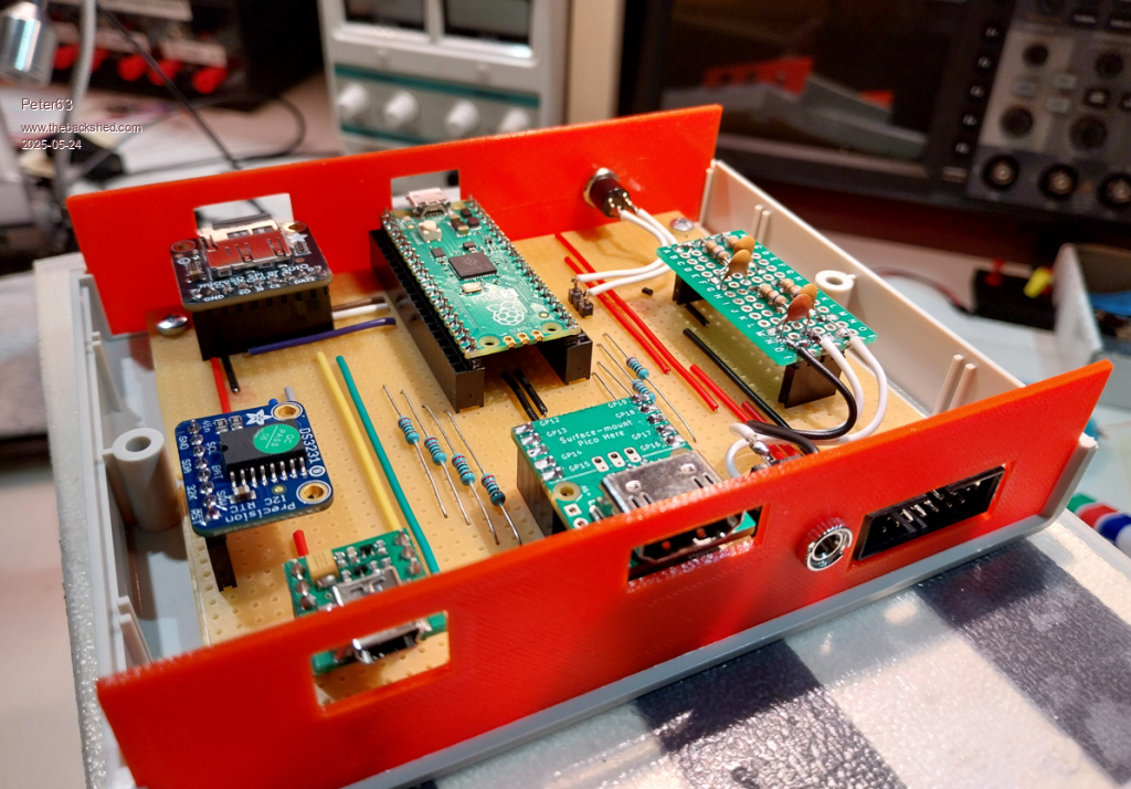

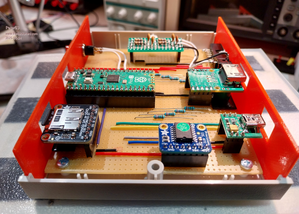

Posted: 12:42pm 24 May 2025
Hello

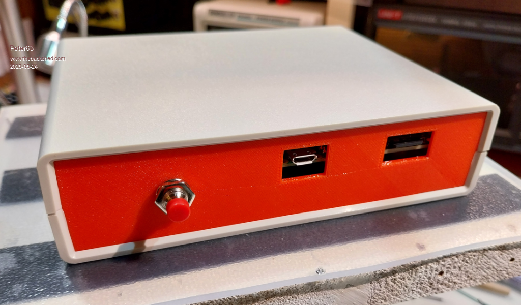

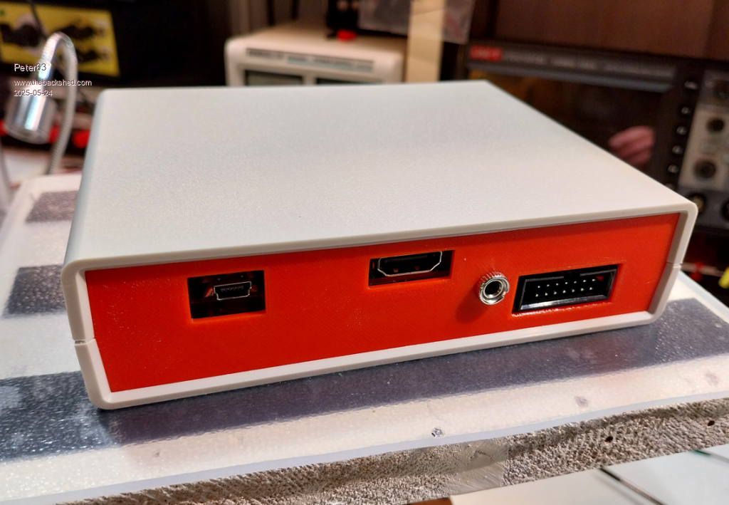

This is how I built my own HDMI version some time ago. Maybe you can get some ideas for your own building. Case is G738 from Velleman
/Peter63
Posts: 9136
Posted: 03:30pm 24 May 2025
Very nice, Peter, and very red! :) It looks like you might have used pad board? I was being deliberately awkward and restricting myself to a relatively easily available size of ordinary stripboard and the cheapest decent enclosure I could get. It was just for the challenge. :)

Very nice and clean build! If you do it like this, it will run as stable as a manufactured pcb..

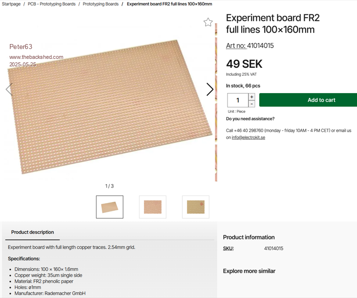

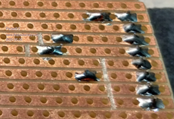

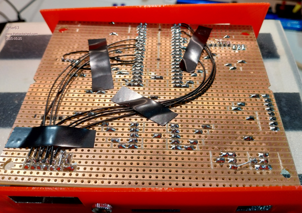

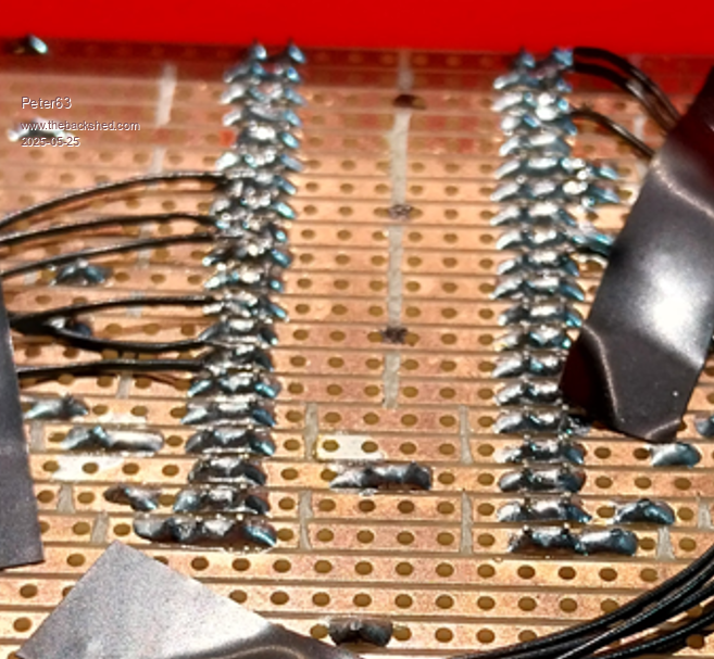

I took some photos from underneath, where you can see that I used a nice knife to break the tracks. Using stripboard reduces the amount of wiring.
Using stripboard from https://www.electrokit.com

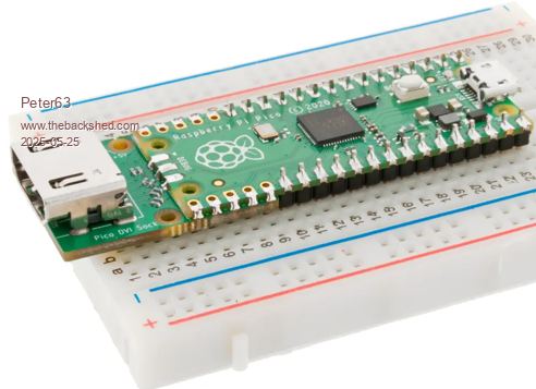

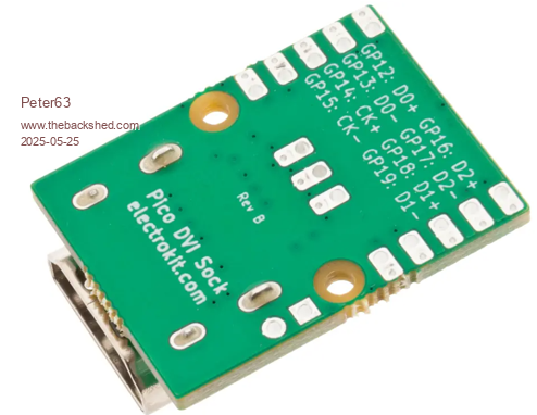

I use DVI Sock from electrokit
/Peter63

Superb build!
I could order @electrokit but way too expensive with 5€ for the socket and 10 for shipping. I've seen this long ago but now disappeared from market.. but very nice with the option to solder it directly. So if I ever want to see HDMI there is no other option for me than to cut a used cable from trash and solder the wires directly..
Anyone tried, does HDMI output work as well with the 2350B? HSTX pins are same pinout as least..
Posts: 9136
Posted: 09:23am 25 May 2025
The DVI Sock and the HSTX are fully compatible AFAIK. The system was deliberately designed like that. The "accepted standard" DVI pins for the RP2040 were simply copied over when the HSTX was being created. They are more expensive than the Adafruit module though.
