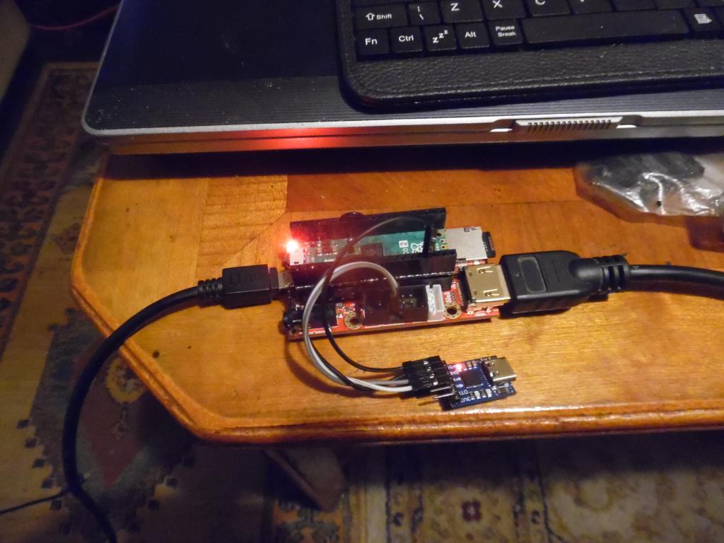

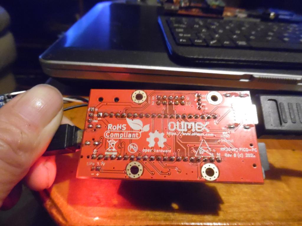

got an olimex 2350a / pico 2 but don't use it.
> option list
PicoMiteHDMI MMBasic USB RP2350A Edition V6.00.02b0
OPTION AUTORUN  ON
OPTION FLASH SIZE 4194304
OPTION COLOURCODE ON
OPTION KEYBOARD UK, 0, 0, 600, 150
OPTION CPUSPEED (KHz) 315000
OPTION DISPLAY 30, 53
OPTION HDMI PINS  1, 3, 7, 5
OPTION SDCARD GP22, GP6, GP7, GP4
I had to add a link for sound but just flashed a prog and it seems ok and neat so why don't I use it? I must have bought it for something.
stanleyella
Joined: 25/06/2022
Posts: 2807
Posted: 07:46pm 21 May 2025
what was wrong with it as it looks good for new users but there must be a catch or it would be more popular
I notice using usb version usb to ttl works to program but needs dissconectig for code to run and connecting usb to ttl stops program running disconnecting it runs again.
just posted as beginners show interest in the board and be fair it looks tidy but it's got faults with mmb but mine is "working"

What is printed as product description on the backside?
I found a board looking like yours but seems to be originally designed for RP2040.
I think this is used by some here and can be setup with OPTION PLATFORM OLIMEX but I'm not sure. I looked at the scheme and I think its ok for the 2350.. Your usb problem sounds unusual to me, maybe other can help better.
scheme I looked at
I think your ground wire for usb is wrong..can'T see excatly but check
Edited 2025-05-22 06:27 by dddns

@dddns there are faults reported with this board and mmb but I can not remember them only there is a wire joining 2 gpio pins
stanleyella
Joined: 25/06/2022
Posts: 2807
Posted: 08:40pm 21 May 2025
it's ground for usb to ttl
no usb connected, that is on the pico. power goes to the olimex board
all strange
edit checking usb to ttl sir
Edited 2025-05-22 06:46 by stanleyella
dddns
Joined: 20/09/2024
Posts: 925
Posted: 08:46pm 21 May 2025
I think you plugged it in one too far to the left. please check that
On the pico, not at the socket
Edited 2025-05-22 06:49 by dddns
stanleyella
Joined: 25/06/2022
Posts: 2807
Posted: 08:59pm 21 May 2025
I had the 5V from usb to ttl plugged in to ground doh.
plugged into vbus pin 40 and no need for power to olimex board.
mmedit working through usb to ttl ok.. which is usb c and tiny.
Thank you for your help @dddns

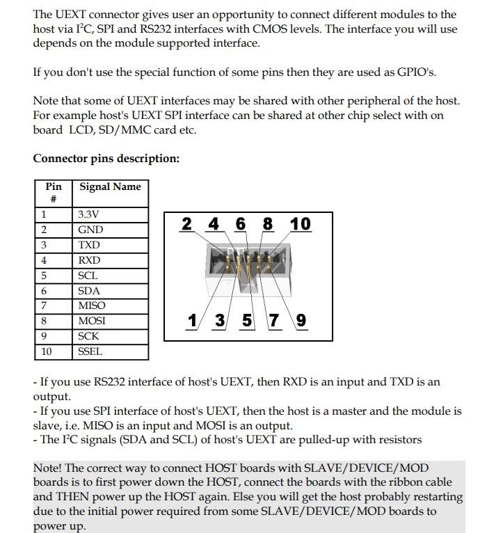

found from info 3.3V is input supply so use 3.3V out from usb to ttl instead of 5V to vbus... works
Edited 2025-05-22 10:29 by stanleyella
dddns
Joined: 20/09/2024
Posts: 925
Posted: 06:19am 22 May 2025
The board has its own USB connector for power source. Your USB TTL serial converter should be only connected to UEXT via GND,RX,TX

Now type blindly: option reset olimex usb
Give a reset to the Olimex.
When connecting the Terminal via rx and tx next to the usb, note that they must be connected crosswise and then make a standard 3-pin cable so that it always works well.
Greetings,
Jan.
