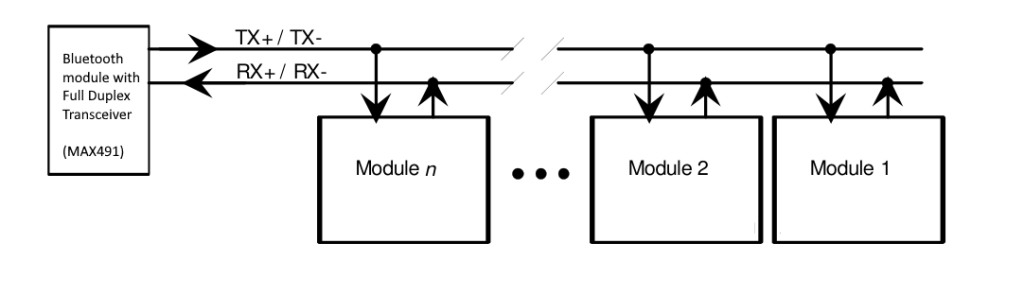

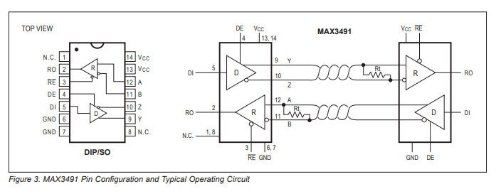

Posted: 11:48am 17 May 2025
this maybe?
Another possible way
