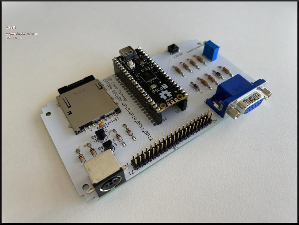

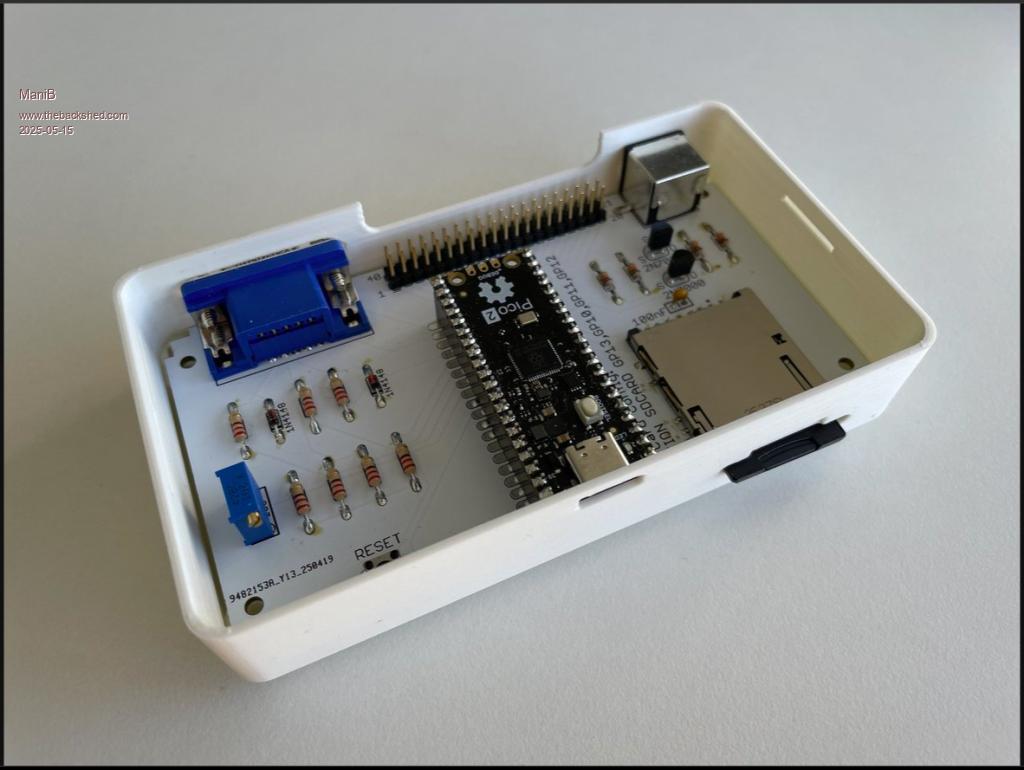

Hello everybody,
I am currently setting up four PicoMite VGA refernce boards using the Raspberry PI Pico 2 and the Firmware "PicoMiteRP2350VGAV6.00.02RC23.uf2"
The manual says that after installing the firmware, the Pico boots up and a virtual COM port is started on the micro USB port. Here is the excerpt from the manual, page 6:
"When the copy has completed the Raspberry Pi Pico will restart and create a virtual serial port over USB on your computer. See the chapter Serial Console below for the details of using this."
Well, MMBasic is running, I can use VGA monitor and PS2 keyboard without any problems. Actually everything works, but on my Windows PC, which I have connected to the Pico with the USB cable, no COM port is displayed.
What is the reason for this?
Here are my currently set options:

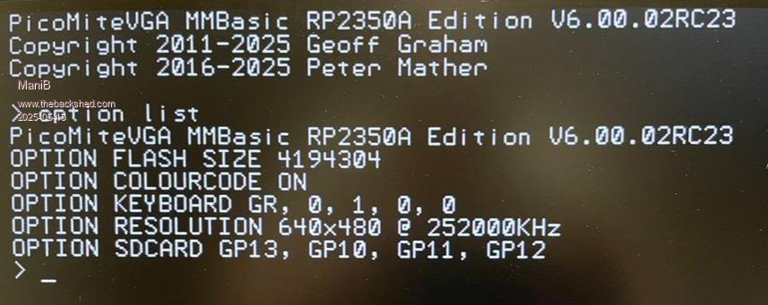

> option list
PicoMiteVGA MMBasic USB RP2350B Edition V6.00.02RC23
OPTION FLASH SIZE 4194304
OPTION COLOURCODE ON
OPTION KEYBOARD GR,0,1,0,0
OPTION RESOLUTION 640x480 @ 252000kHz
OPTION SDCARD GP13, GP10, GP11, GP12

Is this option list coming from the device shown on the picture??

And yes, the OPTION LIST is from this device shown in the pictures.

Yes, you are right, i made a mistake. The OPTION LIST shows:
PicoMiteVGA MMBasic USB RP2350A Edition V6.00.02RC23

  Mixtel90 said  This looks wrong.
Installing PicoMiteRP2350VGAV6.00.02RC23.uf2
will NOT give
as OPTION LIST unless it's buggy.
The GPIO pin list looks correct though.
TassyJim is right. You probably need to clear the flash to reinstall the correct firmware.
Personally, unless someone can recommend a version that they have tested on this particular PCB design, I'd try one of the earlier Release Candidates or even 6.00.01, the last full release.
Yes, it is IS WRONG!
Sorry, I made a typing error when typing the screen message.

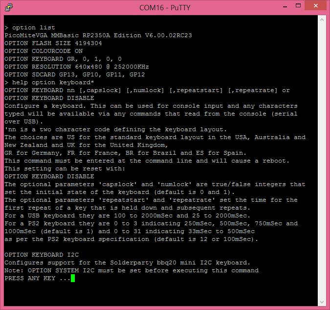

The corrected power-on message is: “PicoMiteVGA MMBasic RP2350A Edition V6.00.02RC23
Here is the screenshot:
Im using a Windows 8 PC. I will try this out this evening with my Windows 10 Intel NUC computer and then report what happens there.
Thank you for your help.

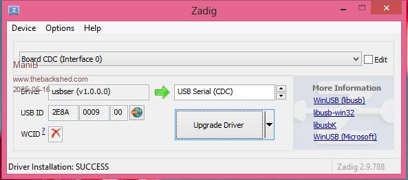

From the manual page 8.
Windows 7 and 8.1
The USB serial port uses the CDC protocol and the drivers for this are standard in Windows 10 and 11 and will load automatically.
The Raspberry Pi Foundation lists Windows 7 or 8.1 as “unsupported” however you can use a tool like Zadig
( https://zadig.akeo.ie ) to install a generic driver for a “usbser” device and that should allow these computers to
connect. This post describes the process: https://github.com/raspberrypi/pico-feedback/issues/118

The keyboard setting are your problem
