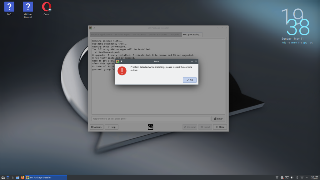

Tried to install VB on MX Linux tonight, but it failed with an error message, but I don't know WHERE to find the console output it is directing me to.
There is no tab in the background, indicating that this is where I need to go, but even if there WAS, I would still be a bit lost.
Can anyone help?

I'd be very surprised if VBox won't install on MX. It may be easier on something else, but I doubt if there's anything to prevent it. Isn't it in the MX repos?

  Mixtel90 said  I'd be very surprised if VBox won't install on MX. It may be easier on something else, but I doubt if there's anything to prevent it. Isn't it in the MX repos?
Yes, I thought so, anyway.
I just used the MX Tools/Package Manager app thing, found it in the drop-down tree of all the software you can install, clicked that and followed my nose from there.
It was then I got the error.
Unless I am supposed to be installing it in some other way?
Thanks for the link to Github, dddns, I have loaded it in a tab, and will have a bit of a read through it later on.

Go to their side, download the required package and double click it. That should do it.
